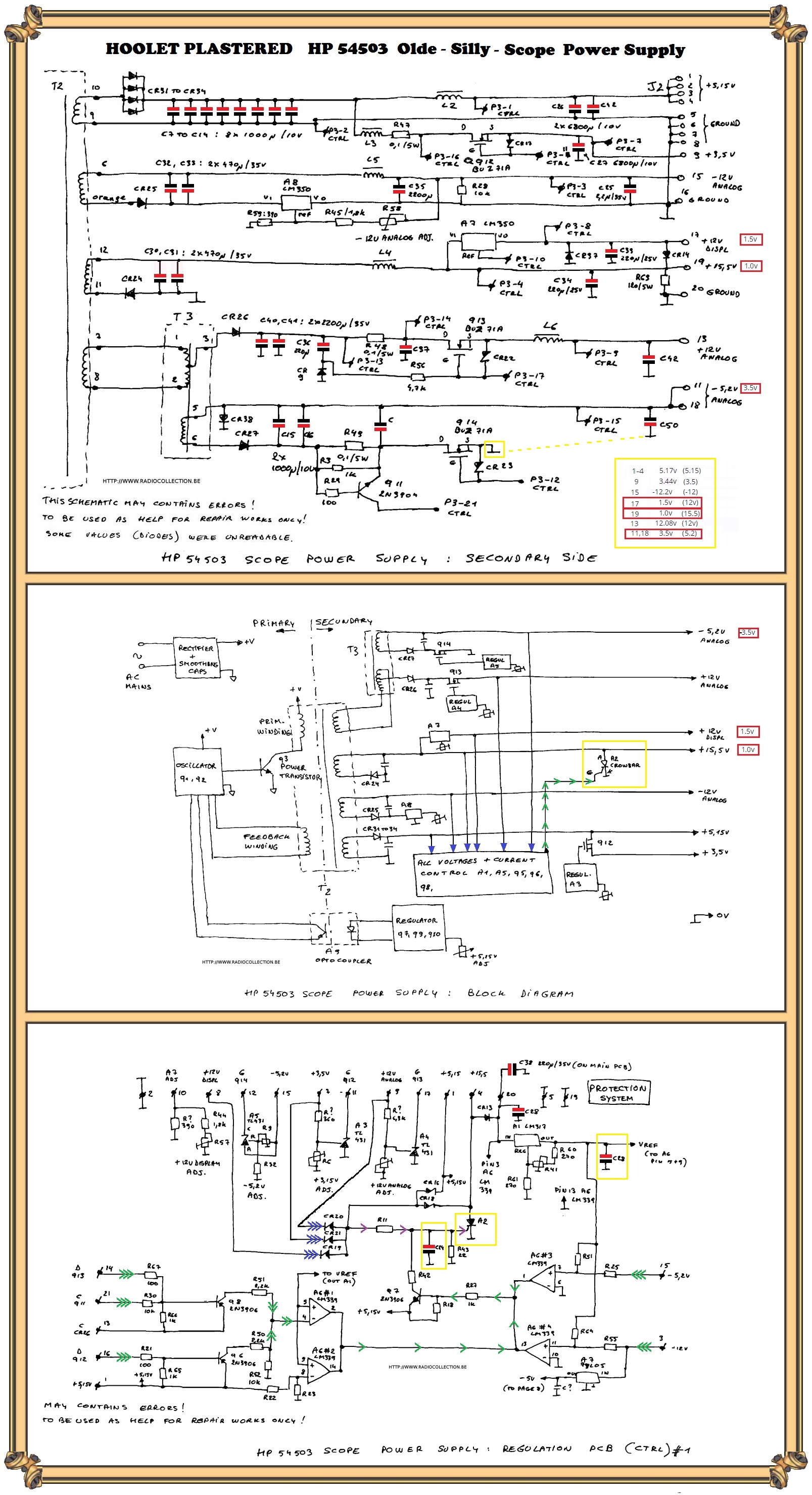

I understand that the power supplies on these 'scopes are troublesome. Mine is actually working but is giving off an unpleasant burning smell. Information about these units seems scant but there is a reverse engineered circuit diagram here http://www.radiocollection.be/images/restaurations_img/HP54503/supplyHP54503.pdf
The track between CR11 and R16 seems burnt.
My immediate thought was that leaking electrolytics were causing the problem. It isn't easy to isolate the secondary side sections except for -12v one starting with C32 as this has a lead connecting it to the transformer. I disconnected this but the smell persisted so I went on to replace C7 to C14 as there were more of them. This didn't help either and there is no sign of distress in any of them.
I really don't want to proceed further with a blanket replacement of caps and I wondered whether anyone here has any experience of these or any suggestions for a more scientific approach.
I repair valve radios as a hobby so have some experience with electronics but the limit of this is circa 1949! I certainly haven't tackled anything like this.
Any suggestions would be gratefully received.

GEE-OH-GOOD-GOSH--GOLLY-DAMNED-ALL-A-MIGHTY ! . . . .if THIS is what you are using on feeble OLD tubed radios . . .don't you DARE let us see what instrumentation you are using on Tran-sist-um-oh-ferrized and Interly-Grated-Circuitious designed units .
You are in a completely different type of power supply from the rest of the units linear based units, when you are . . . .on page 5.
If it seems that the R16 / CR11 pair are running hot you just might have a drive situation that is producing less than a fully saturated condition on Q3.
That would cause a decline in driven power output from the windings on that T2 power transformer.
Then the outputs feedback loop, via that A9 optical isolator, would tell the Q1 unijunction to up the power drive to the Q3 power transistor.
Initially, see if any or all of the derived voltages off T2's secondary supply windings are up to spec.
ANALYSIS:
Pick a given run time in minutes and evaluate the touched temp of both R16 / CR11 . . . .make mental note.
The two most suspect parts in that base drive supply loop would be a t . . .i . . .m . . e . . . related capacitance decline or ESR onset in electrolytic caps.
( Remember . . . . . those little puppies have acquired some age on them. since day one of circa 1991. )
In this immediate circuit, that would be the coupling provided by C12 . . .470ufd / 35VDC cap and the slightly less suspected C46 . . .33ufd . . .just by virtue of being a tantalum unit.
The same conditions on C22 and C23 could be at fault.
(However. . . .if those happen to be some ORANGE units they are being some premium units, that tend to be a bit more bullet-proof with age onset.)
Now if you don't have them on hand, the sub of a shunting pair of 100 ufd units across them should give you some answer, or you could also read the AC ripple . . .or any decline . . . across them after being put in circuit.
Thassssit . . .for now . . . . .
Sub in some other units and do that same run test and then compare those R16 / CR11 parts temperatures.
MARKED UP SCHEMA REFERENCING:

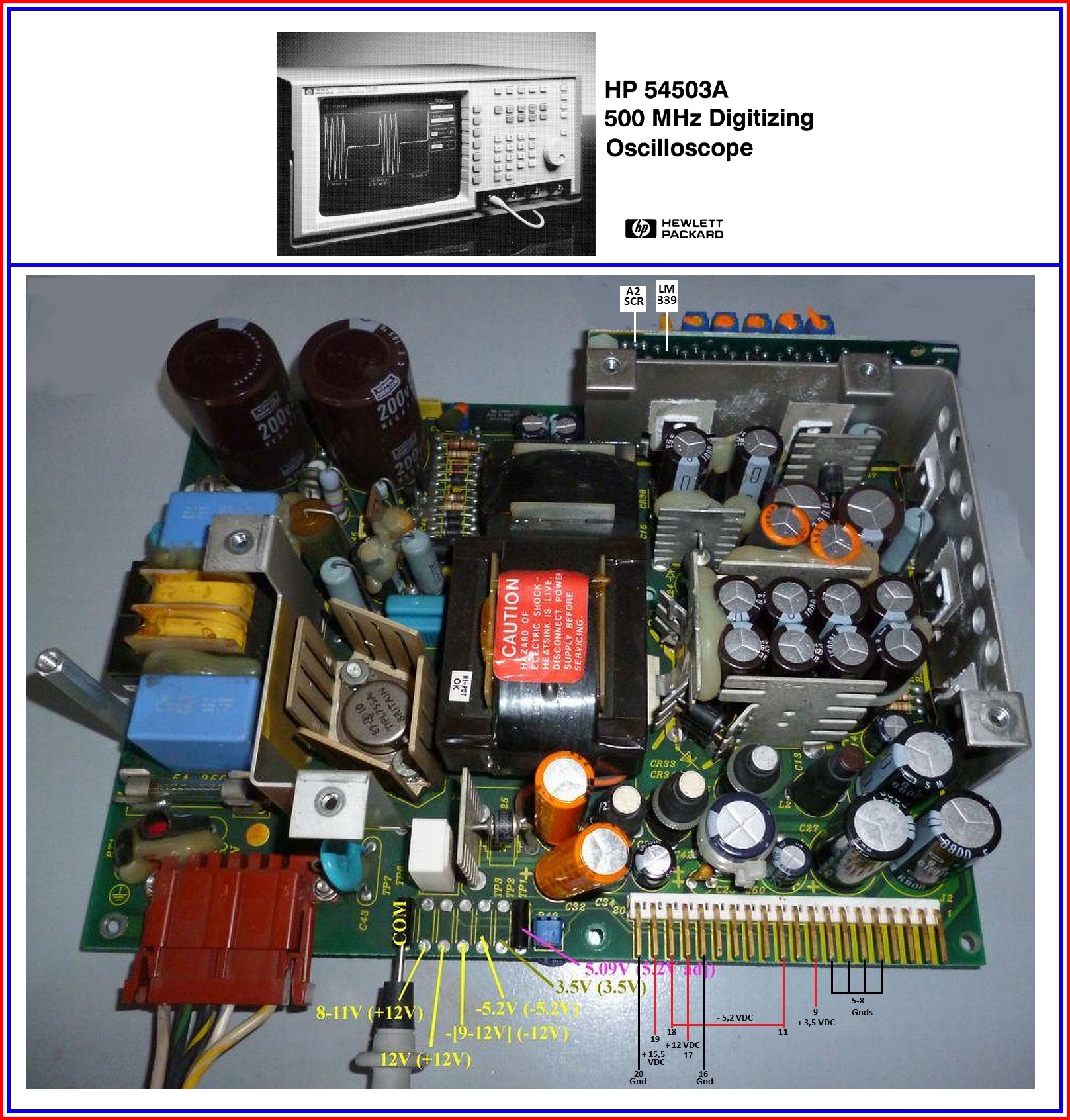

Wow, thank you! The 'scope is actually my son's but it seems to have taken up residence here since it started to smell.
Just one thing before I start - is it safe to power up the power supply whist it isn't connected to the rest of the scope? If I powered up a valve radio with the output valve removed the smoothing caps would remain charged which might prove a bit surprising if I touched them. There are an awful lot of electrolytics in this power supply and I would rather not take any chances.
Here is a photograph of the component side of the unit by the way.

It would definitely be best to leave the PS connected and be getting loaded down by the circuitry.
You know about the high voltage associated with Q3 from your "OLD tube" know how.
I make connections with clip leads or solder tacked on wires and thereby, that lets me " remote " those meter readings, for added safety.

I wonder whether I could have some more help with this. It worked fine when I left it on a soak test for 5 or 6 hours so I gave it to my son for a project he is doing. After he had used it for a few hours it started to cycle on and off. I have only just had a chance to look at it again and I noticed some arcing at the base of one of the old caps. I assumed that was because of electrolyte which had leaked out of it so I ordered a complete set of replacements. I replaced this one first of all and cleaned underneath it before |I replaced it. There was still some arcing so I scraped around it to remove any carbon deposits and that stopped it. It still cycled on and off so I set about replacing all the caps. I tested it every time I had replaced a few and the problem remained. I have just replaced C19 and now all that happens is that the fan turns very slowly. I am getting only low varying voltages on the output pins.
I have checked my soldering and cannot find any mistakes so I am assuming that I have disturbed something when I have been handling it. Are there other places I can test voltages to try to pin down the problem? Having come so far with it, it would seem a shame to give up with it now. I can post the actual readings on the output pins fi that helps.

As a matter of interest I have taken voltage readings on the output pins with no load as follows:
1-4 5.17v (5.15)
9 3.44v (3.5)
15 -12.2v (-12)
17 1.5v (12v)
19 1v (15.5)
13 12.08v (12v)
11,18 3.5v (5.2)
All the values were with respect to earth, but pins 11 and 18 don't seem to be earth referenced so maybe the value there is ok. How can I check this properly? I cannot find any problems with C 30, 31, 33 or 34 but there cartainly seems to be a problem with that line. Any suggestions would be very helpful.
The values in brackets are those according to the circuit diagram.

Under load the values drop a lot and become very unsteady. Pins 1-4 become 2v. 3 also 2v. 15 = 10v 17= 1.5v. 13 = 10.2v. 11, 18 = 0.3v. Those are average values as they constantly vary.

I am placing on some initial Marked Up references to be consulting , but you query:
So my very first question / action would be for you to confirm . . . . .
We can see that on J2 connector that using an OHMMETER in lowest . . .ohms. . . range should be revealing that pins 5 thru 8 should be interconnected.
Reaching over to measure pin 16 and pin 20 should also reveal a like interconnecting .
NOW . . .we figure out the grounding question . . . . by initially noting that the +12 VDC analog supply as well as the MINUS 5,2 VDC supply are using an isolated T3 transformer for their power derivation.
The derived voltage from CR26 plus C40 and C41 is generating a straight forward supply with only a slight
variant in the respect of using Q13 / BUZ71A series power FET as a series switch in delivering a slight delayed timing of full powering up of that supply..
Lets revert back to the ohmming function and doubly verify that the C42 final filter cap of that +12 VDC analog
supply supply is having its NEGATIVE lead making a connection to our earlier cluster of grounds.
If so, then we should expect that the other MINUS 5,2 Analog supply should also be tied into that common buss.
BUT here is its difference, it is using CR27 plus companion filter capacitors C15 and C16 for power derivation
and has the created NEGATIVE voltage flowing on down from C15 and C16 to the next C? filter (get that number for us) and finally down to the last C50 filter.
So you now want to test the POSITIVE connection of that C50 filter to see if it also is grounded to all of all of our other grounds.
If so, that clears up all of the ground interconnect verifications.
The only variant now is the design of that last negative 5,2 Analog supply, if normal, the cathode of the CR27 and the shared interconnects to the POSITIVE leads of C15 and C16 would go straight to ground.
Not so in this design, as they are wanting a current sample of this supply and are using series inserted R43
( 5 watts, no less . . .babycakes ! )as a current sampler, with its shunt voltage take off fed to the base emitter junction of Q11 and then feed back to the control board thru Q11' s emitter.
That was the first slight disruption of supply flow, getting to ground , with the next one being the Drain -Source
disruption at Q14 /BUZ71A series power FET, which is dependant upon gate drive from the control board at P3-12 for making that final ground connection of this circuit loop.
I really think that this supply drop is associated with the fault at the pin 17of the supply +12 VDC Display source supply voltage , being now reduced to 1.5 VDC and the MAIN fault, is with the +15,5 at pin 19 of J2 now only being 1 VDC.
I think that a voltage or current sensing fault from a supply level has been detected and fed to the control board and it has activated the gate of the A2 SCR and thereby crow barred that supply.
Most suspect would be a long time related decline in capacitance of filters.
I forget if you have capacitance reading equipment or ESR evaluative capabilities.
Also I think that your voltages might be stable with no loading placed upon the unit, less our major 2 supply voltages and the minor decline of 5,3 to 3,5 VDC on the last one.
On the bottom schematic you can see 3 BLUE ARRROWED mark up routes that can avalanche their respective zeners and feed gate drive thru R11 to activate A2 crowbar shutdown.
Its imperative that the YELLOW marked cap C29? has not had signifiant overall capacitance decline or its
reduced time constant will make that leg of circuitry hypersensitive / erroneous.
Same situation over at C28, associated with a clean stable reference supply for the LM339 comparators .
The GREEN ARROWS mark ups are related to the other voltage lines and current samples that are fed into that A2 SCR gate circuitry via the Q7 transistors C-E junction.
Can you supply R11 and R42 resistive values.
I am most suspicious of the four orange electrolytics in the unit.
Are your power semiconductors, that are being heatsinked, still having silicone wetted unions/bonds to the
heat sinks . . .OR . . . has the moist / wet silicone element, long since migrated laterally, and left the devices
sitting high and dry on a thermally isolated, bone dry layer of tin oxide ?
Will continue on TS procedure . . . after your info fill ins.
