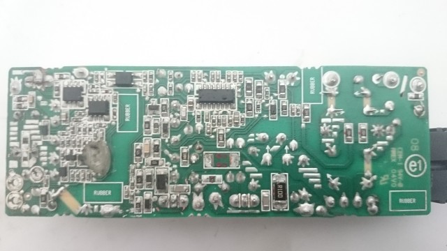

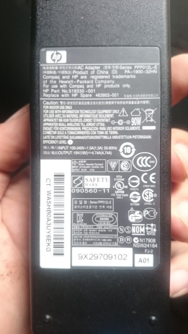

What is causing the noise in the video and how to fix
Suddenly the lap stop working and i get that noise the adapter didn't make output dc to run the laptop
After I disassemble it and recorded the video i was checking it and i tried to plug it again to the electricity the noise stopped but it's Still not working

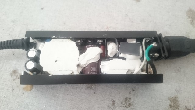

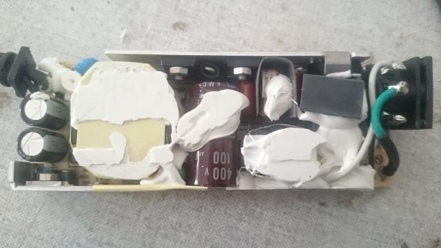

check the wires. the wires sometimes break on the device end, and have to be cut and spliced. I had one that was busted on both ends., I had to rewire the plug and the board. There is alot of white pucky in there. That's quite a bit of white pucky. Might call it a pucky covered mother!

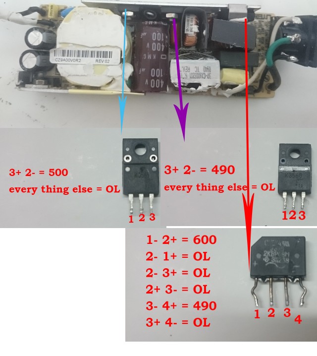

i measure away of the wires...i measure on the board the ac in it's 220 v and i measure the dc out on the board is none 0
pharaon
Oct 28, 2014
458
Oct 28, 2014
458

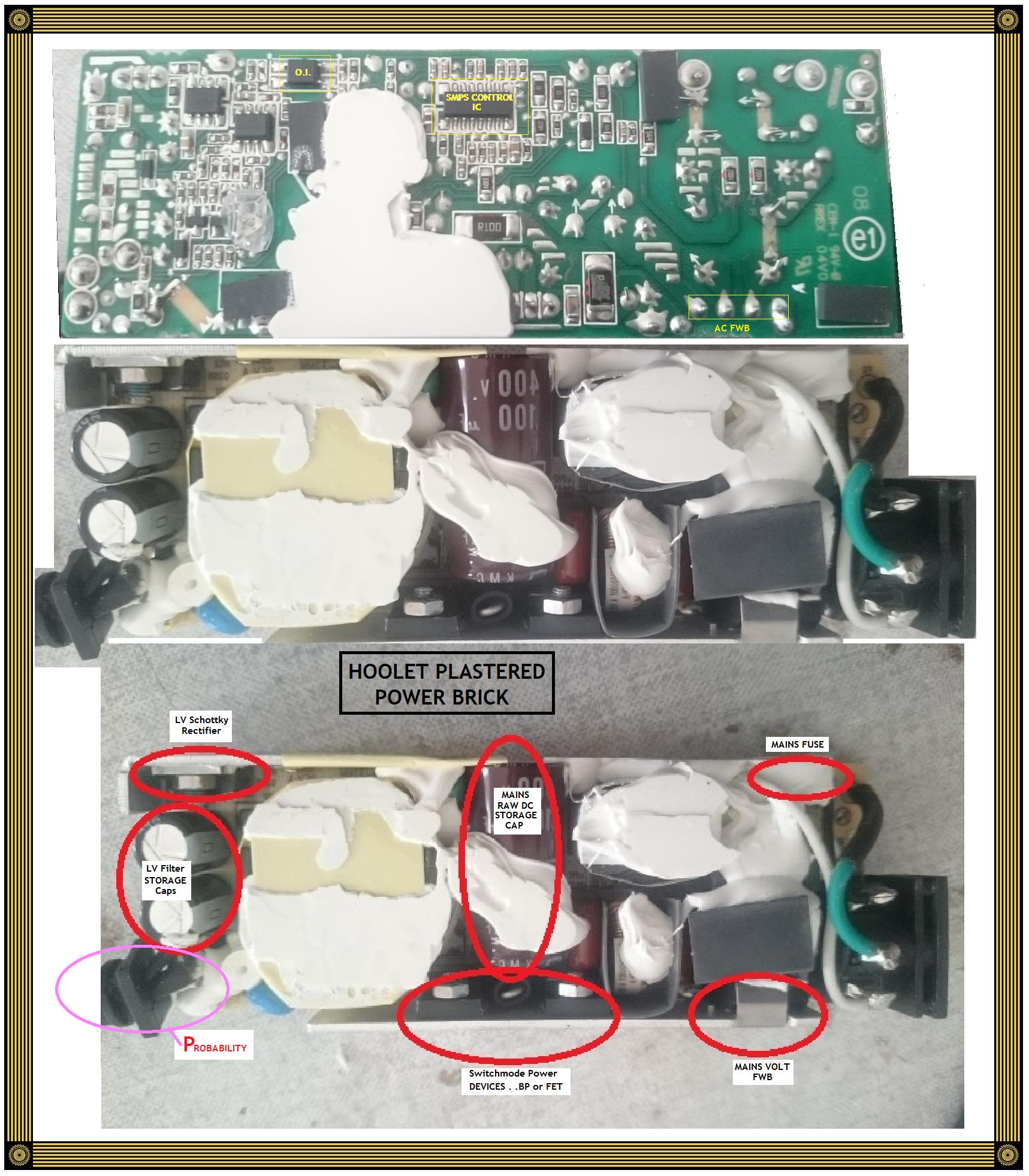

all the red circuit units is working
why no output dc
the one at the right bottom corner is a fuse

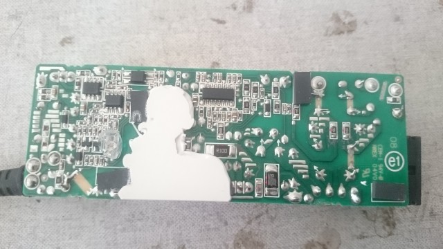

OK here I am looking at this unit and starting a side by side working PCB side to FOIL side drawing comparison and you come up with your last info.
I then add it to the bottom and identify your circled units, which you claim as working . . . . but being uncertain of your manner of that confirmation.
If you are correct, there should be 19VDC across your LV storage capacitors at the left of the page, THEN that voltage gets routed on over to the output wiring.
If that voltage is NOT at the output connector, then see if repeated use and flexure . . . over time . . . has not broken all the wires inside the insulation on either wires internal conductors..
When you get down to 3 or so strands trying to carry 19VDC at ~ 5 amps the wires can vaporize then arc at every flexed closure and arc and vaporize open an even WIDER wire gap.
Or if that voltage is NOT at the final LV storage caps, your earlier stage circuitry is not working.
Tell us the part numbering of the 16 pin flat pack SMPS controller that this unit is using.
Also, might as well give the two LVPS sections two 8 pin IC’s numbers also . . . . and if exploration evolves to it . . . might need to take a pointed wooden sucker stick and abrade off the LARGE blob of white “pookey” that is covering a large area of the foil pattern. (Little nearby clear blob says . . . .me too . . .ME TOO ! )

1-The output caps is new so they are working
2- i test the main raw dc storage cap after disconnect it of the board and it's working
3- i test the lv schootkey recetifier after disconnect it of the board and it's working
4- the 8 legs ic is LTA803n
hope you can help me diagnosis the error
I test the ac and dc on the board not the wire

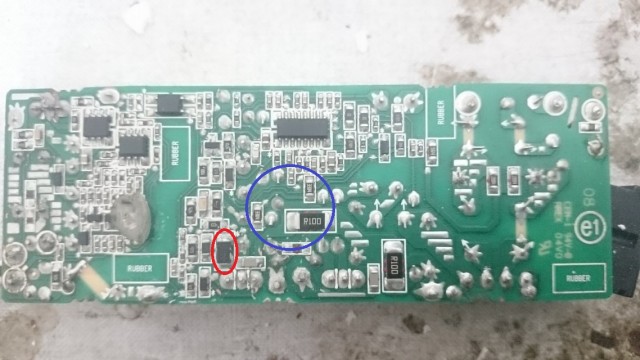

i measure the dc vote on the main raw dc storage cap and it was 330 v
also over the switch-mode power devices ..BP or FET it was 330 v dc

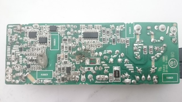

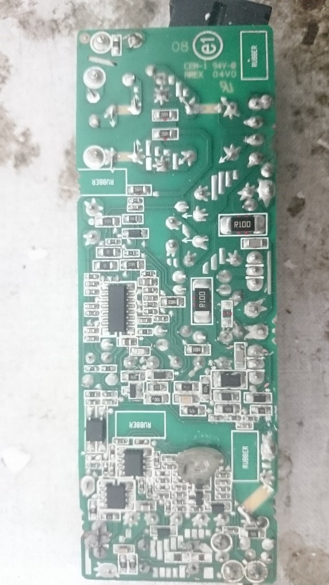

i tried to measure the DC volt between the red circuit and i get shorted in the blue area as shown
and this is after cleaning
the should i replace the blow up R100 with 100 ohm resistor?

You have two power FETs there I can't read for sure, if both are K3568's or K3569's or a K3568 and a K3569 . . . . I am certainly thinking that I am seeing one of both.
Your good R100 should be a 10 ohm, check it out.
it's K3568 and a K3569
but still what is the cause there's no dc volt at the output if every thing is working i also gave you the measurements on the big capacitor
