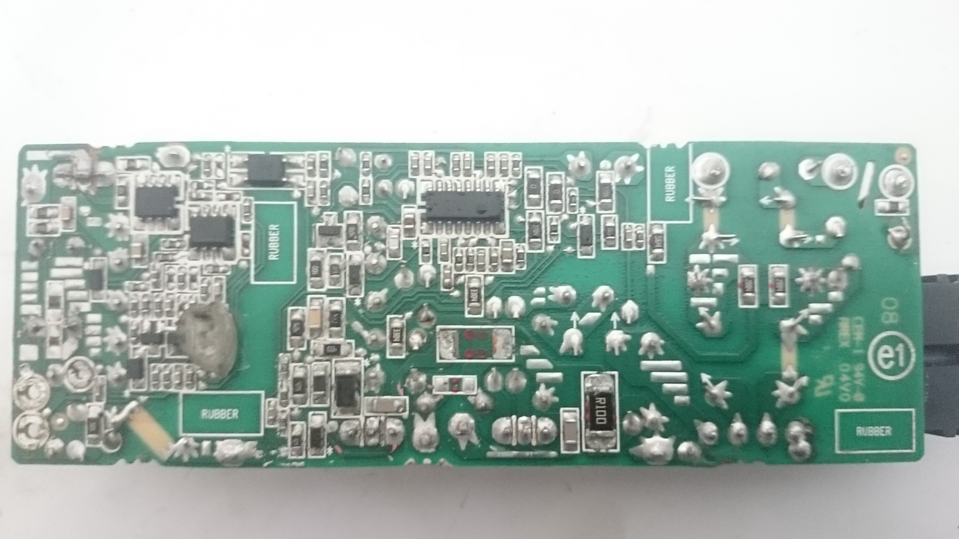

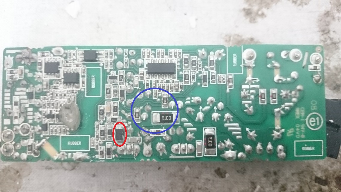

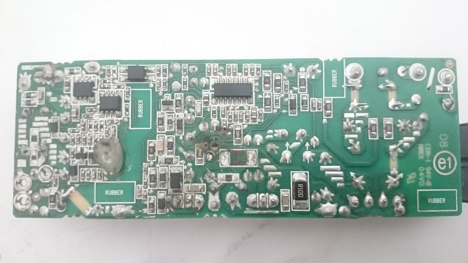

In post 17 you have 3 board pictures , the top one looks good with all parts on it
The botom picture looks good with one R100 pulled
BUT the middle one looks dismal in its center area, I hope that is not the PRESENT state of the board.
There is no chance that you are just plugging this board in to test it . . .is there ?
It should always be tested with a 60 watt incandescant lamp wired in place of the fuse OR be wired in series with one of the ac power wires coming into the board.
Just want to confirm that .

Well in previous post it below because i was measuring the dc volt on it
So I'll replace the resistance
But what test exactly you want me to do

yes i plugged it directly to the AC power and tried to measure VDC over the board when i get it shorted as in this image....i measure VDC over two sides on red circuit part and get shorted in the blue area like the image
and this after i clean it
so first i need to replace the damage parts before i can test again with lamp
the damaged parts is
R100 resistor
the second R100 resistor gave me 1 Ohm on avometer so i assume it's bad too
the k3569 in post 16 got shorted
and i don't know yet what else could be damaged
the k3569 can't find it right now in my city hope if there's another replacement part can do it's work

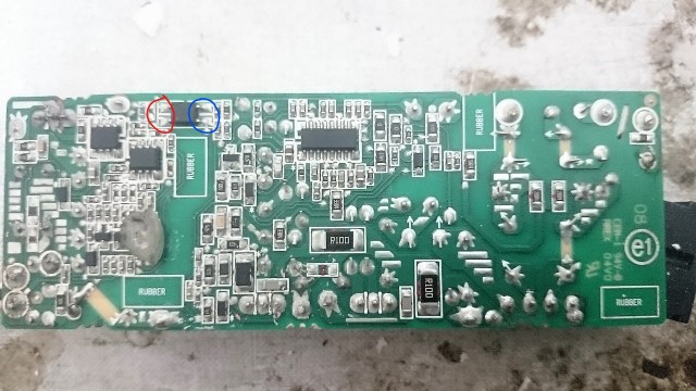

there's a lot of images just make circle around the part you want it's details and i'll get it
pharaon
Oct 28, 2014
458
Oct 28, 2014
458
on diode scale in my multimeter i tested that piece with circles around it
there's short(beeb) between the blue circle leds
the red circle leds give reading like 1.023 and 1.300 on diode scale
the number of that piece is lx9 375 x
i guess that mean it's not working right
