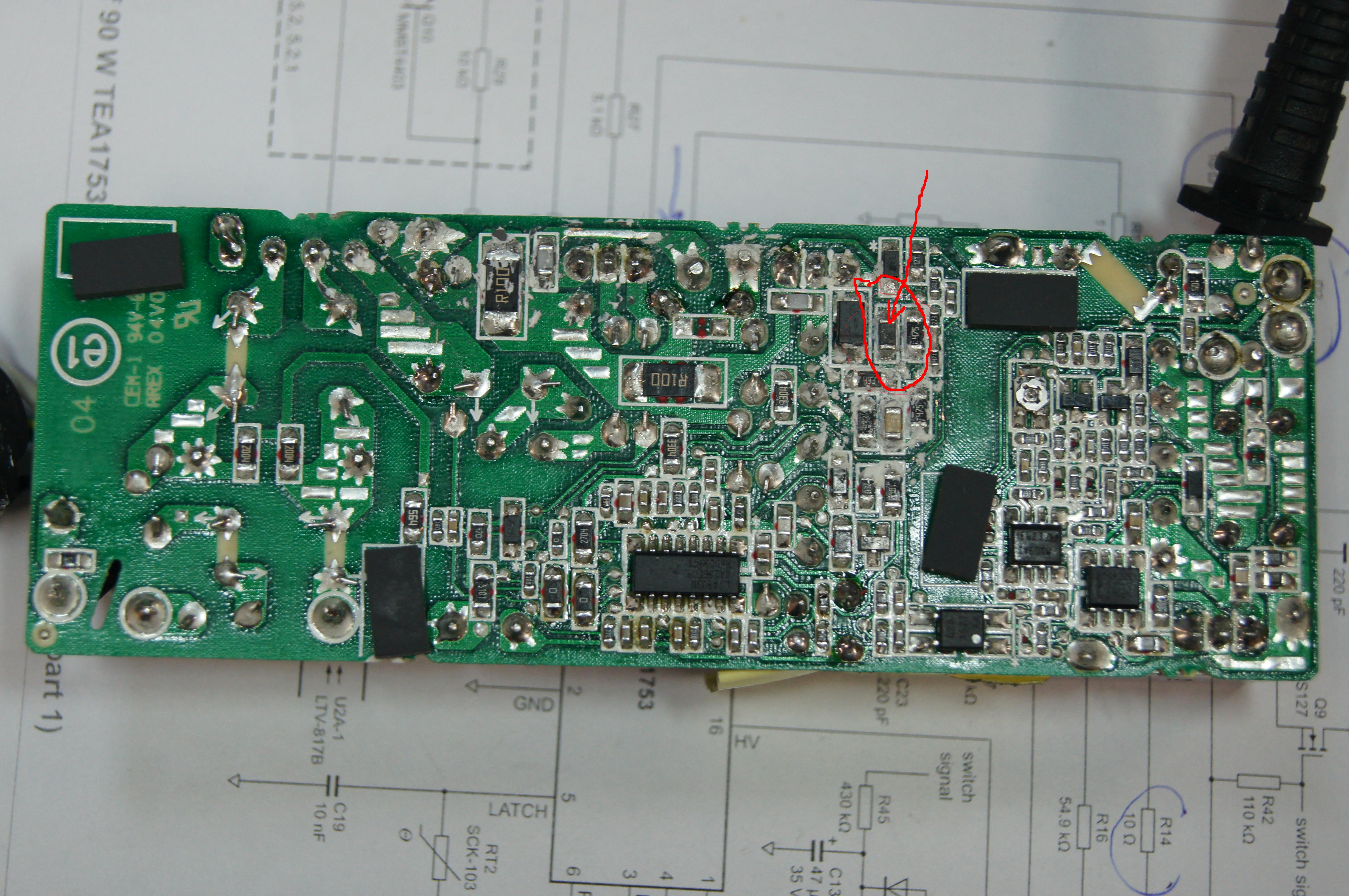

Sir pharaon . . . . .
there's short(beep) between the blue circle leds
The beep should have been on the internal LED leads of that optical isolator and what was its reading in millivolts on the meter.
The OI's other section is the dual junctions of a light detecting transistor junction . . .thus the reason for about twice of what I am expecting to hear that the LED is being.
I dont believe that you have ANY problem with that item.
Can you give us the numbering that 16 pin flat pack IC just above the central 10 Ω pwr film resistor.
I am sort of thinking of an LTA 301P. controller.
I HIGHLY suspicion that one of its internal totem pole driver transistors inside of it was blown to bits, as the original,( just being referenced), central 10 ohm resistor was blown up by the blown power FETS drain source directly shorting together and also sending their high voltage level up the 10 ohm unit to that driver section of that PWM controller IC.

i got clear picture for lenovo pa-1900-56lc adapter
i think it's the same circuit

is there any way i can test the LTA 803N to check if its working or not
I cannot find a datasheet, so I don't even know what the chip is, let alone how to test it

Found this in other website
Claim that LTA803N is a counterfeit of TEA1752 / TEA1753
Is that true

after the first burst the 15a 250v fuse were blown as well so i changed it with the resistor
now i tried to try the unit again with 60watt bulb
and the new fuse were burst again
so there must be shorted some where but i don't know where exactly
that's a 3.15A fuse NOT 15A
quite possibly the bridge rectifier --- appears to be on the heatsink on the top right of your latest pic

How to check if the lta803n got dc current or not
I mean to check if the problem from something else but it
as I said before .... we don't have a datasheet so we don't even know what each pin does
without that info, it is unknown what voltages to expect on which pins
