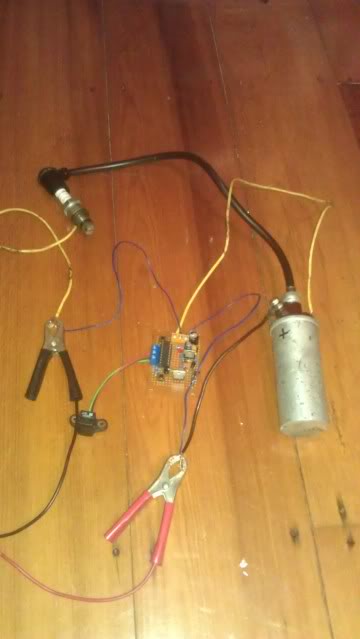

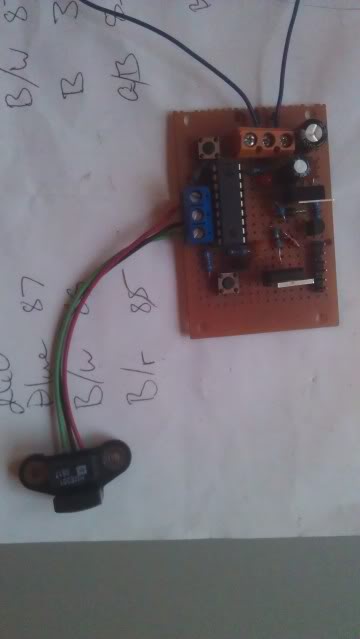

mmcl055
Feb 26, 2012
33
Feb 26, 2012
33
330R is too much. Try 47 R
Also the zener needs to be connected reverse biased from the resistor and connected to ground so that it absorbs transients over 18V.
I just noticed your output capacitor on the 5V regulator is pretty low too. 10 to 100uF may be better.
OK I've done all of these recommendations and the circuit looks like this. Although I have just noticed that in place of the 1N4007's I have 1N4004's does that matter?
attachment.php
The 5V rail is now 4.94V. Good enough?
The gate of the IGBT now switches from 0 to 7.08V, however with just the multimeter in place of the coil I get 12.1V to 13.1V when the gate switches and the IGBT get's quite warm. I'll recheck everything I guess....
Here's a couple of photos of my setup.
mmcl055
Feb 26, 2012
33
Feb 26, 2012
33
Actually, I'm totally wrong. Not sure what I've been smoking....
OK, the output from RB3 switched between 0 - 5V. good.
The other side of the 1k resistor switches between 3.7 - 7.2V
The gate on the IGBT is 4.8 - 5.5V
