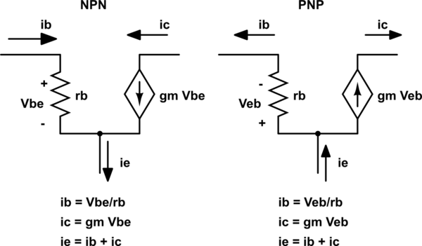

My 2nd question is about the ckt below:
73iBCMlb
The questions ask to find the input impedance, output impedance and the overall gain, Av. My confusion is about how to handle the current source when calculating the input impedance and the overall gain. Referring to my work below, I'm stuck at handling the current source to give the proper KVL or KCL equations. I assumed that there is merely a Vin voltage drop on R1 because when I did source transformation on Iin connecting Iin*R1 in series with R1 I got the wrong answer. When figuring out Av, I got confused as well. If anyone could point me in the right direction that would be great, as well explain a method for current sources to solve Av without computing Av0 first, would be great.
P.S. These problems must be done by hand, so unfortunately simulation is not an option.

What model are you using for the Tr.?
The Pi model has vbe in it not ib?
73iBCMlb
Given that the input is a current and the output is also shown as a current, I would have thought they wanted the current gain, Ai, rather than the voltage gain, Av. Which is it?
Correct, indeed the question asks for the overall current gain, Ai.
OrangeArav
Jul 14, 2015
38
Jul 14, 2015
38
Now, the question is how can we find Ai without converting the current source into a voltage source? Do we need to do that always? If not, what is the procedure for finding Rin, Rout, overall gain, when there is a current source for a BJT? Circuits are hunting me back... :)

Current source cascades, are not much different than voltage source cascades:
when you drive an amp with a current source you need to use current dividers (parallel) instead of voltage dividers (series) and multiply the chain like you did for voltage sources.
Rin, Rout are calculated the same the only difference:
an ideal current source has Rint=infinity.
an ideal voltage source has Rint=zero.
