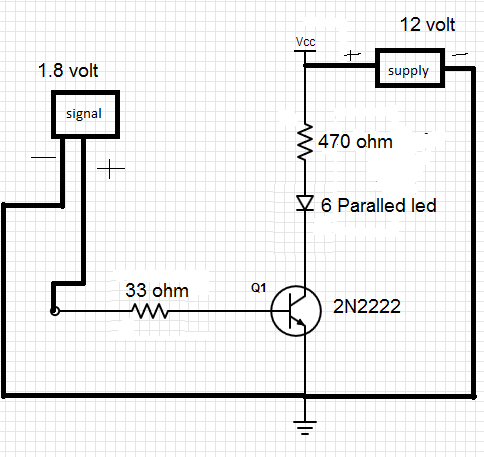

i choose 2N2222 transistor since it can handle the load i need (up to about 500 mA).
but i don't know if its suitable for board or not since my signal voltage is 1.8 and load is 12v 120ma .
so according to equation on the https://www.electronicspoint.com/resources/using-a-bipolar-transistor-to-turn-a-load-on-and-off.30/ article
R=((V-VBE)*hfe/(Iload*n)
when
V(signal voltage)=1.8 (red diode voltage on the board)
VBE=0.8
hfe 50 when ic =150
Iload = ic = 150
n = 3(i dont know exactlly)
so R will be 111ohm and i choosed 100ohm resistor for it.
if i'm wrong correct me please.

You say you want up to 500mA. Let's say the gain of the transistor is 50 at that current.
Your base resistor is about ((1.8 - 1)*50) / (0.5*3) = 50/1.5 = 33 ohms. Use a 33 ohm resistor :)

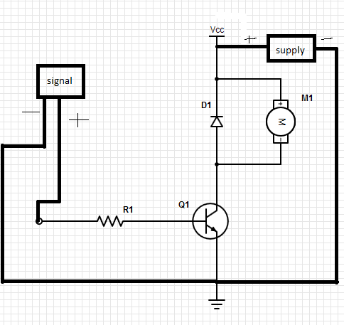

i have some questions if you do not mind please
in this circuit
where should i connect the signal voltage ,power supply, and what is that earth sign there, i mean where should i connect it?
and by the way supply has 2 wire , how can i connect it to 1 like that vcc?
i know this questions is stupid enough to not to be answered but i have more of them :):):)
lets start with using some educated guesses
I will give you one answer .....
it goes to the -V of the battery or other power supply
now that leaves 2 other terminals for your other 2 choices .... what do you think is the most likely solution ?

well i think you said the hard part.
but this is my guess
but i do not understand if supply going to be connected on VCC how it's going to work with that diode direction?

That diode is in this circuit because it is running a motor. You would take out the diode and motor, and replace it with your string of LEDs and resistor, all in series. The LEDs should point in the opposite direction of the diode in your schematic.
FYI the diode in the schematic you posted is called a freewheeling diode. When you stop current to motor it becomes a generator, generating a voltage opposite to the supply voltage that runs the motor. This diode shorts out that opposite voltage, which does 2 things. It keeps the voltage from becoming very high and blowing out the transistor, and it acts like a brake on the motor, using up the excess energy by making it a generator with a short circuit on the output.

so it is my final design i think :
it's still confusing me , specially how the transistor is not between supply and diode?

Q1 is acting as what is called a 'low-side' switch. If it were between the supply and the diode it would be a 'high-side switch', but would be more dificult to control with the 1.8V signal.

Thank you Bob that was very interesting ,what a single diode can do !
If you are on the highway and an accident occurs... police stop traffic...
Traffic no longer flows before or *after* the police-man ;)
Funny way of looking at it, but it's true.
In electronics, you need a circuit... and you can break that circuit anywhere along the path to stop current flow. Just so happens in this example, you are breaking the circuit between the LEDs and negative supply terminal.

Getting there, but you still have the LEDs wrong. You cannot parallel them with one resistor. The reason for going to 12V was to allow you to put several LEDs in series. You should be able to two string of 3 LEDs + a resistor in each string. Look at the LED resource again for how this is done.

You can place LEDs with different forward voltages in series. As long as you set the current correctly, they will split the voltage as each requires. For example;
2 red LEDs Vf 2.5V
1 blue LED Vf 3.3V
Total voltage of LEDs 9.1. So you need a resistor that drops (12 - 9.1) = 2.9V at 20mA, which is 145Ω.

Well... if you have the ability to re-wire more, it would be in your best interest *not* to put any LEDs directly in parallel with each other.
The resistors I quoted, are based on using one resistor for each LED in case you can't manage to re-wire any of them in series. If you run *any* in series, or *any* directly in parallel you will need different value resistors.
The tricky thing about this, is that LEDs are *current* driven devices, which is why (at a bare minimum) we use a resistor to limit the current flow... now, if you have 2 LEDs in parallel, your resistor must be sized such that it allows enough current for two LEDs to light. If the 2 LEDs in parallel are not *exactly* the same (There is no *close enough* here) then the current through them will not be split evenly. This means that one LED will *always* be fed more current than intended. This will shorted the life of the LED and if the worst case happens (it burns out) then the other LED(s) in parallel will end up being force fed the current that was meant for the now dead LED resulting in a chain reaction of your LEDs in parallel dying.
Don't get me wrong, it's possible to use LEDs directly in parallel without an LED on each one, but this is not one such instance.
If you can't rewire any in series, I strongly urge you to place a single LED in-line with each LED on your device. You will need 60 resistors, and it will draw more current, but it's a better option than direct parallel LEDs. You just need to cut the lead, or wire on either the anode or cathode of each led, then insert a resistor.

Simply add the Vf of the LEDs you want to add in series and make sure it's less than the source voltage you want to use. If the source voltage will vary.. (ie, in a car that often runs between 12, and 14.4V.... use the *higher* voltage for your calculations and omit one LED from the string... ie, if you can *fit* 4, only use 3)
It's important that the LEDs you choose to run in series with each other all have the same mA rating, because the mA through every item in a series string will be the same. A resistor is then chosen to provide the desired current (mA) when you provide the *left-over* voltage from the calculation you have done above. (Source V, - Vf of each LED in series)
You can make as many 'strings' as you want, and you can then connect almost any number of strings together in parallel...
So ... no, you cannot have 6 LEDs in series with a 12V source, but you can easily make two strings or 3 LEDs + 1 resistor each. Then simply attach both strings in parallel.
