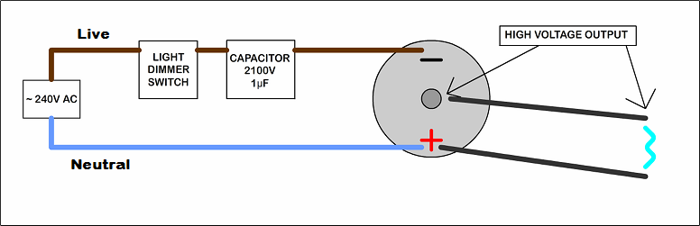

After viewing this video:
I decided to have a go with it myself and create some sparks using ignition coils.
Now without sounding too ignorant... How can I connect multiple ignition coils (3+) in series together to create higher voltages (and thus longer sparks)?
This is my set-up with 1 coil:

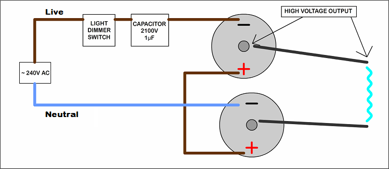

And my set-up with 2 coils (a longer spark is created):
I want to be able to connect 3+ coils increasing the voltage further. Is this possible?

unless ignition coils dont need specific polarities the second image would not work
You need to connect the positive from the first (top) to the negative of the second (bottom) and the positive of the second to the neutral line
I assume they don't need specific polarities, because the second image does work.
I have tested the exact set-up myself.

To go back to the original question, the answer is no.
Ignition coils are auto transformers with input and output connected together. In order to connect the secondaries in series for higher voltage, it is necessary to have the primary and secondary isolated from each other.
An alternative way of producing a high voltage is to use a voltage multiplier (Cockroft/Walton) such as is used in televisions to get several kV.
