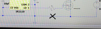

Hi guys.. im oliver. Im just new and not knowledgeable enough in the behavior of the ir2110.. i have a problem in my circuit.. im trying to make a class d amp using the ir2110.. but im testing it for now in the ltspice with the use of pulse signals from two voltage sources. Each have a dead time(Lin, Hin).. it is working with the supply of 100 volts using irfb4227 mosfet.. i have an output of pulse signal which is ok..
But the thing is, how am i gonna make an output that starts from 0v, -100v to +100v or from 0v, +100v to -100v from my half bridge config mosfets? Or shall we say, how make it that has an alternating pulse output from both positive to negative supply voltage swings vise versa?
I have attached a files to make things clear.. i maybe incorrect in making the circuit that is why im refering to you guys!! Thank you so much for the help!

The common junction of V1 and V2 needs to be connected to 0V(ground) reference.
I already contacted the two on the ground which gives me have of the dual supply rail which is correct but i still wanna know how to implement the neg to pos rail to make an alternating voltage swing

@kellys_eye : Usually one would make this connection as shown. But in this case this gnd connection will short circuit V2 whose negative end is also connected to gnd.
This page shows an application circuit using 2 × 24 V power sources which can be replaced by the required 100 V sources. The short circuit is avoided:
Q1 connects R3 across B1, thus the signal at net R3(2) (blue arrow) is positive.
Q2 connects R3 across B2, thus the signal at net R3(2) (blue arrow) is negative.
@yummymetalman : Note that B1 and B2 need to be floating (floating = no connection other than shown in the application) with respect to the power supply of the IR2210 and the signal generating source.
This page shows an application circuit using 2 × 25 V power sources which can be replaced by the required 100 V sources. The short circuit is avoided:
@Harald Kapp
Thank you.. i tried it but still not working. If its ok with you, can you please make a circuit out of my schematic i place earlier pls.?

Remove the wire shown here:

Add 1:
What is V)N005) and V(noo7)? These node names (n005, n007) are mewaningless to us as we can't see which nodes these are. Use node labels like so
to identify the nodes. These will then show up in the plot as V(out) in this example.
Add2:
What you want to see is the voltaeg across the load resistor R3. This can't be shown as a smple node voltage since node voltages are always with reference to GND, but R3 is not connected to GND any more. You need to use the differential voltage probe like so:
To do this, hover the mouse over out1, press the left mouse button, then drag the indicator to out2 while holding the left mouse button pressed. Release the left mouse button once the second indicator appears.
