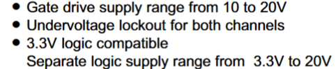

hello I have two IR2110 and am building a circuit as shown in the pictures attached I want to know the voltages needed on the HIN ans LIN

Logic-level voltages. Have you checked the datasheet?

as I understand 3.3 logic means that Logic low - input must be between 0V and 0.8V. Logic high - input must be between 2V and 3.3V.
That's correct. So in LTspice you can use two pulse voltage sources each with a 20ms period and a 50% duty cycle. Give one source an 'off' voltage of 0 and an 'on' voltage of 3.3. Give the other source an 'on' voltage of 0 and an 'off' voltage of 3.3.
