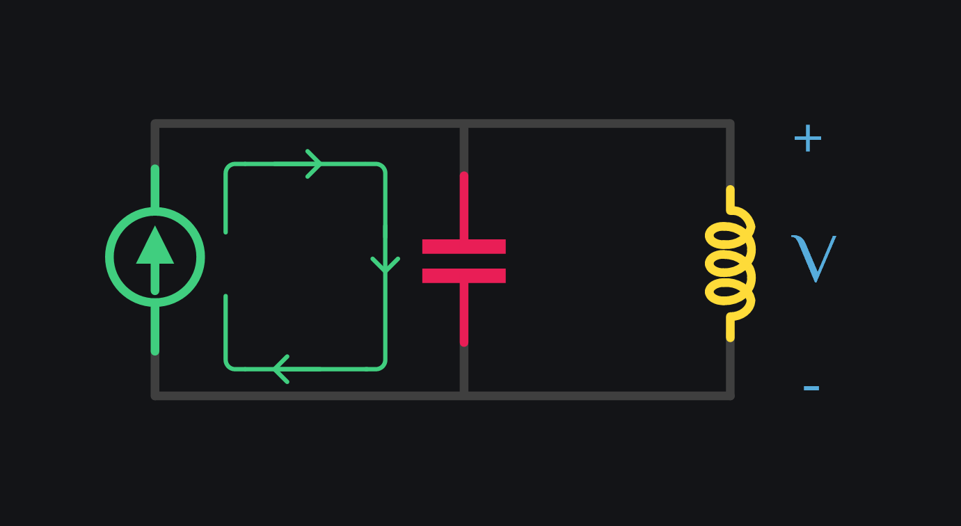

Hello there,
I'm going back to fundamentals in electronics, and I end up with questions that I can't answer satisfactorily.
The object of my turmoil is the parallel LC circuit, and more especially what happens when it is connected to an AC voltage source that delivers a sine signal at the resonance frequency of the LC circuit.
I'm trying to "get what's happening" without using Kirchhoff's laws, because I want to seize the physical phenomenon instead of proving it mathematically. Showing algebraically that the global impedance of the parallel LC circuit is maximum at resonance frequency does not satisfy me because I want visualize what the charges do in the circuit.
My questions comes from this thinking of mine:
Imagine you connect that AC source to the parallel LC circuit, without having charged the C nor the L before, and neglecting resistive effects. And imagine that the AC source delivers a sine signal at the resonance frequency of the LC circuit.
Now I will describe what I think happens, please correct me if I'm wrong.
During the first quarter cycle of the sine signal, starting with a positive voltage (STEP 1):
- The C (capacitor) gets charged, the current through it going from max value to zero, and the voltage at its ports from zero to max value (following the input AC voltage).
- As for the L (self), the voltage at its ports follows also the input AC voltage, and at the end of the quarter cycle (max positive voltage), the current through it is just about to be positive (the current drags 90 degrees with respect to the voltage at the L ports, as its reactance shows).
Then (STEP 2), the AC voltage starts to decrease (starting the second quarter cycle, just after the max voltage). Therefore, the positive charges accumulated on the positive plate of the C will start to leave the plate as stated by q = Cu (I won't dive into the specifics of drift velocity vs wave velocity, but think in terms of travelling charges instead).
My understanding is as follows:
1) The positive charges leaving the positive plate of the C will go through the L, and the "90 degrees delayed" positive current through the L will correspond to that flow of charges from the C to the L (because at resonance, the modulus of the C-reactance equals the modulus of the L-reactance).
2) As a result, the C is not "asking for" current anymore, and all the current is L is "asking for" comes from the C.
3) As a consequence of 2., the current from the AC source will now be zero, meaning that the impedance of the parallel AC circuit can be considered infinite (open circuit). The voltage between the two ports of the LC circuit will continue oscillating (we neglect the resistive effects), with no current ever delivered by the AC source anymore.
So my questions are:
1. Is what I describe correct ?
2. About point 1), it is correct to assume that it's the electromotive force induced by the L that make the positive charges from the C travel through the L instead of going back to the positive port of the AC source ?
I apologize for not bringing any plots to support my question, but I guess you are familiar enough with the topics to get my point.
Lessee... you reject circuit analysis using algebra and well-known mathematical formulas that describe how capacitive and inductive reactance vary inversely with each other as a function of frequency. Then you postulate that when these reactances are equal (same modulus in your words) the parallel LC circuit is at resonance and no energy is drawn from the AC excitation source. You then jump to the conclusion that if no energy is taken from the AC source, then the impedance of the parallel LC circuit must be infinite.
So, IMHO, the answer to your question is NO. Hand waving, which is what you are doing, is not a substitute for science, engineering, or mathematics.
You talk about "positive charges" as if these really occur in a parallel LC circuit. They do not. In a parallel LC circuit there are NO positive charges that participate in circuit operation. Everything that occurs is a result of the flow of electron current. Electrons are point-like particles that exhibit mass and a unit of negative charge. The valence electrons of the atoms in the wire are responsible for any current or voltages you observe.
The "charge" on a capacitor is neither positive nor negative. It simply represents the physical separation of numerous electrons between the two plates of the capacitor: Q (charge separation in coulombs) = C (capacitance in farads) x V (voltage measured between the two capacitor plates). Since there are two terminals on a capacitor, the polarity of the voltage will depend on how you measure it. If a "charged" capacitor has a positive voltage measured from one plate with respect to the other plate, then it will have a negative voltage if measured from the "other" plate to the first plate. The charge has not changed.
Charging a capacitor means you take electrons from one plate and move them to the other plate, by whatever means. There are no positive charges moving between the capacitor plates.
Visualize all you want, but that doesn't make it so. Charge is an invisible electrical property, so even if you squint really hard, you will never "see" to visualize charge. You can see the effects of charge, but electrical charge cannot be visualized meaningfully. J.J. Thomson is credited as being the first person to "discover" the electron by observing the effect of magnetic and electrical fields on the behavior of light emitted from the phosphor of a cathode-ray tube (CRT) by a beam of electrons. However, it was the American physicist Robert Andrews Millikan (1868-1953) who first determined the charge on an electron using the motion of charged oil drops in a gravitational and electrical field.
There are NO net positive charges in a capacitor because that would require that protons (atoms) be moved along the wires connected to the capacitor. What actually happens in a capacitor is an external electrical field causes loosely bound and mobile valence electrons in the atoms of one capacitor plate to migrate and accumulate on the other plate. Thus one plate loses electrons and becomes positively charged, because the nucleus of atoms losing electrons is positvely charged, relative to the other plate. The "other" plate gains electrons and becomes negatively charged relative to the first plate. The overall charge of the capacitor is zero because the surplus of electrons on one plate is exactly balanced by the absence of electrons on the other plate. The only way you can determine if a capacitor is "charged" is to measure the voltage between the two capacitor plates, or you can determine that an electrical field exists between the two plates by using a device that measures the presence of electrical fields.
Please do not attribute anthropomorphic qualities to inanimate, non-living, objects. Electronic components are not "asking for" anything. Electronic components obey "physical laws" that are expressed by mathematical relations and functions. Hand waving explanations may "feel good," but they are seldom good analogies in their ability to predict circuit behavior. You need math and electronics theory for that... or you could just call yourself a "maker" and throw stuff together until you get the results you want. The end result my resemble electronics, but it is not electrical engineering.

Thank you very much for your replies. I appreciate you took the time for them.
I must say however that they do not address the issue as I expected, but it is entirely my fault.
I should have stated my background, that would have helped you getting what I was asking for.
I've got a degree in electrical & telecommunication engineering, and a Ph.D. in physics, as well as a college degree in mathematics.
So, I'm pretty familiar with Rutherford-Bohr's atomic model and Maxwell's theory, including the electromagnetic theorems derived from them (even if empirically found before, such as Faraday/Lenz induction law). And I'm not rejecting mathematics to address physics and electrical problems, to say the least...
What I'm trying to do is to set a thought experiment to get a qualitative and intuitive way to think about LC electrical resonance. Using this kind of thought experiment is actually pretty standard in physics, Einstein used a lot of them, and Maxwell himself used this kind of approach in his founding paper "A Dynamical Theory of the Electromagnetic Field" (1865) [see the section about "Coefficients of Induction for Two Circuits, for instance", for instance]. So using analogies to better understand phenomena is pretty standard, it's a matter of understanding the limits of them with respect to the original problem.
That being said, I'm aware that the description I propose has limits. But the limits you raise are not relevant in my opinion:
1. Using positive charges instead of negative charges to describe current has been widely used for decades in electrical engineering, as positive chages can be considered as lack of electrons or, as stated in semiconductors theory, "holes". So there's nothing wrong in using this approach, as far as a particles-based description is concerned. And saying that the current is actually made of moving electrons (in that case) your are not bringing anything new to me :) Actually, if you really want to stress the limit of that approach, it's more that electrical phenomena in variable configurations should be described by waves of voltage/current induced by waves of electromagnetic fields determined by Maxwell's equations, instead of a flow of charged particles. You are indeed making a mistake saying "What actually happens in a capacitor is an external electrical field causes loosely bound and mobile valence electrons in the atoms of one capacitor plate to migrate and accumulate on the other plate." The drift velocity of electrons in a conductor is very very small. So it's not the electrons from one plate that goes to the other plate, but rather the wave of electromotive force that decreases the electron accumulation on one plate and increases it at the other plate.
2. "Then you postulate that when these reactances are equal (same modulus in your words) the parallel LC circuit is at resonance and no energy is drawn from the AC excitation source. You then jump to the conclusion that if no energy is taken from the AC source, then the impedance of the parallel LC circuit must be infinite." No. I'm not assuming the LC circuit is already at resonance, because I'm assuming that the LC circuit is uncharged at t=0. So there is energy taken from the AC source to charge the LC circuit. Saying that infinite impedance leads to no energy is wrong. It's POWER that is null (because current is null), but electrical energy get stored.
3. "Electronic components obey "physical laws" that are expressed by mathematical relations and functions. Hand waving explanations may "feel good," but they are seldom good analogies in their ability to predict circuit behavior. You need math and electronics theory for that... or you could just call yourself a "maker" and throw stuff together until you get the results you want. The end result my resemble electronics, but it is not electrical engineering." As already stated, I'm not rejecting maths to study electrical engineering. I want to support the mathematically demonstrated resonance of the LC circuit with a thought experiment. Physics do not derive from maths, but maths is used to put in from, in a domain of validity, what happens in the physical world. You can be satisfied by just using Kirchhoff's laws and finding the frequency that leads to maximum impedance of the parallel LC circuit. But I'm not.
I ended up finding about the circuit simulator Falstad, and it seems to support the description of my original post. But I don't know the reliability of that simulator, maybe you do.
So, as Einstein said, "If you can't explain it to a six year old, you don't understand it". If you think I'm wrong, maybe you can describe what happens like you would do for a six year old :)
I always find this way of thinking particularly stimulating.
The operation of an LC tank circuit is not complicated conceptually if you look at it from an energy point-of-view (which does require a little simple math).
Once there is energy stored in an ideal tank, the energy is simply transferred back and forth between the capacitor (all the energy when its voltage is maximum, E = 1/2 CV², and the inductor current is zero) to the inductor (all the energy when its current is maximum, E=1/2LI², and the capacitor voltage is zero).
This happens because there is no stable state, once there is any energy in the tank system.
The time it takes for a full energy transfer from L to C, or C to L, as determined by the values of L and C, is 1/4 cycle of the resonant frequency.
An applied voltage at the resonant frequency just serves to apply energy to start the tank and/or top off the energy in the tank due to any real circuit losses.
An ideal tank with no losses would continue oscillate forever, once there is energy stored in the tank.
Below is the simulation of an ideal 1F, 1H tank circuit, starting with 1V on the capacitor (green trace):
The yellow trace shows the tank current, the red trace shows the instantaneous inductor energy, and the blue trace show the instantaneous capacitor energy.
It should now be apparent why the tank inductor current and capacitor voltage must be 90° out of phase.
Does that help any?

Hello Crutschow,
Thanks for your reply. Yes, the energy point of view is interesting to get the picture.
What I was really questioning myself about is the transient phase.
I recommend to have a look at the website I mentioned in my previous post (www.rfinsights.com). It addresses specifically that point, and pedagogically so in my opinion.
