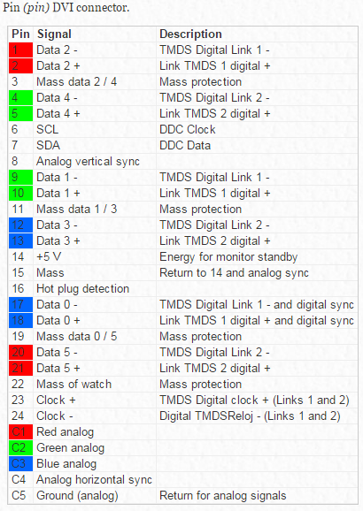

This is DVI dual link pinouts:
I found this on the adress: http://www.alciro.org/alciro/conectores_26/conector-DVI-interfaz-visual-digital_269_en.htm
explained as follows:
The DVI connector is divided mainly into three areas:
  • TMDS. (Transition Minimized Differential Signaling) or Transition Minimized Differential Signal similar to communication systems balanced. Marked on the figure by the brown color has four twisted pair cables one for each primary color video red, green and blue. Each two pairs have a mass of specific protection marked in dark brown. The video signal is synchronized with a pair of twisted wires in light brown line has its own mass. With a video link can transmit high-definition HDTV signal (1920 × 1080) at 60 Hz (139 MHz) for better definitions and better refresh the DVI connector includes a second link in combination with the former provides resolutions higher than HDTV HDTV (1920 × 1080) at 85 Hz (2 × 126 MHz) or WQXGA (2560 × 1600) at 60 Hz (2 × 135 MHz), among others.
  • Pug & Play. Marked in blue has a number of lines that highlight the DDC (Display Data Channel), serial connection with pin I2C Bus SDA (data) and SCL (clock). Are used to detect and display settings when connecting to a computer.
  • Analog. Analog system, marked in green features a pin (pin) for each RGB primary color red, green and blue analog sync with the digital connector makes it compatible with the analog system, reaching a bandwidth of 400 MHz

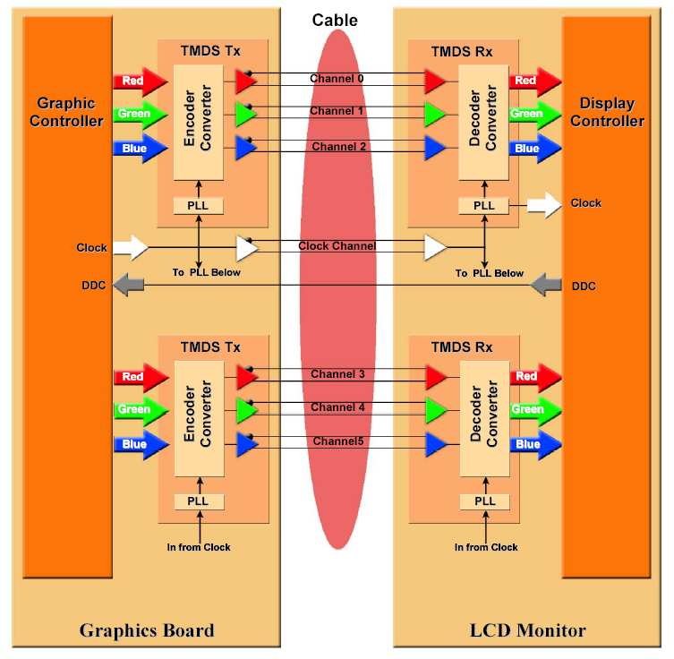

So, 3-D visualization method seems not that hard. Send the pixel datas for Left eye than send the datas for Right eye and on... Communication protocol also seems not that hard! You simply send the datas not encapsulated as you can see below:
As you see, with DVI, we send datas bit by bit and the LCD driver of the monitor decodes received data. So, my question is this: Why do I need lightboost(Or any other 3-D vision product)? What lightboost(3-D stereo feature of it) actually does? Why don't we just use the same communication with monitor and simply send preconstructed Left and Right pixel datas to the monitor and then it decodes the data and do the same job as in lightboost?
