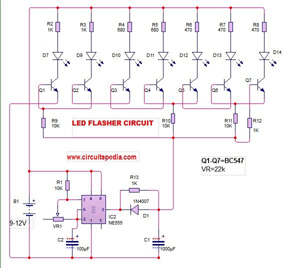

LED Flasher Chaser Circuit with or Without IC

Using a single color red LED:
A CD4017 powered from 9V can output 16mA into a 2V red LED on each output which is enough to burn out its output transistors. Use 150 ohm series current-limiting resistors to share the heat.
