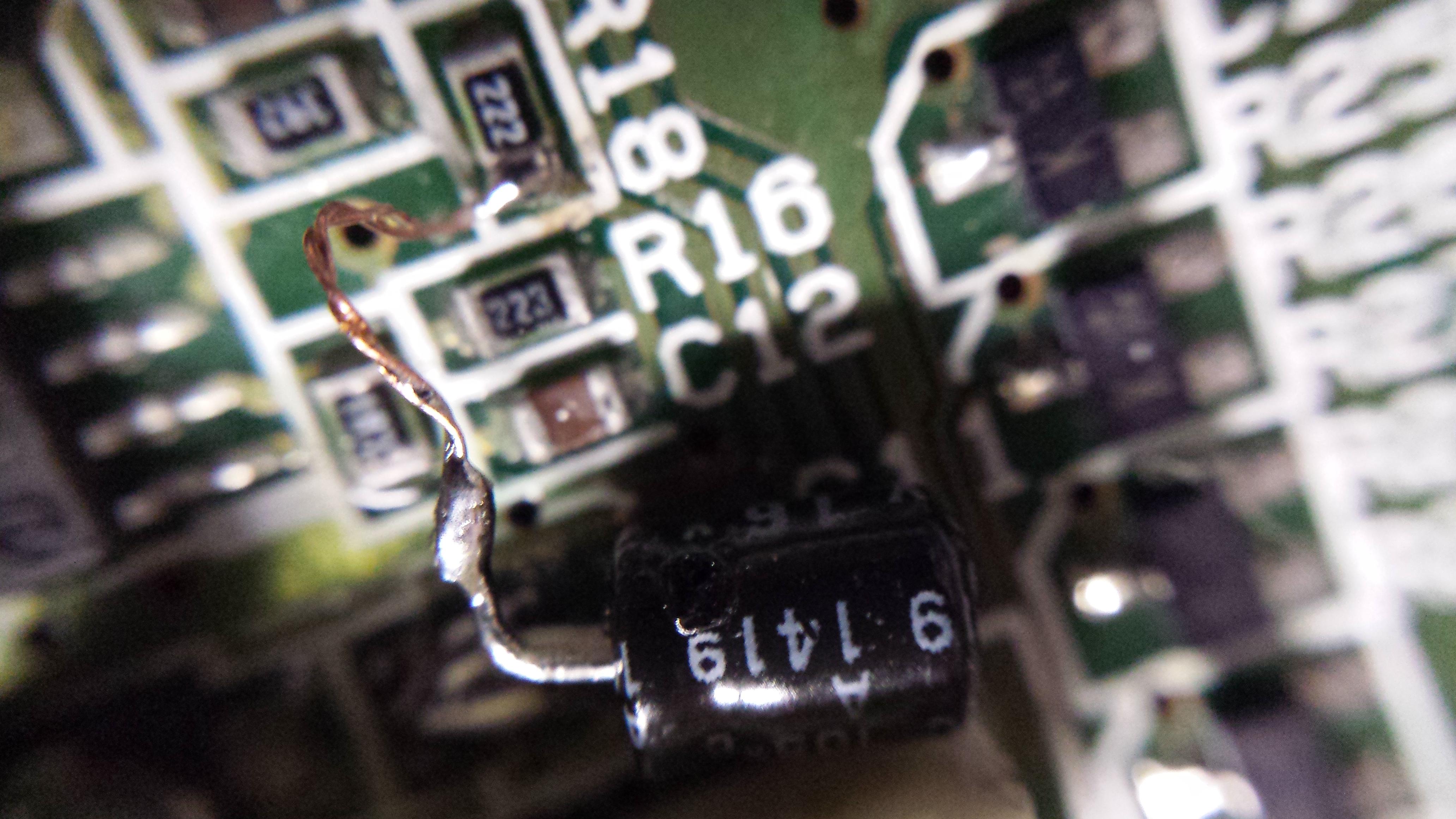

I am replacing most or all of the capacitors on the mainboard of my old Roland XP-50 synthesizer (my original thread is here, not that it’s necessary for context). I have replaced several successfully, but in my inexperience along with my horribly cheap tools and likely cheap/expired adhesive on the board I have managed to snap off a few surface-mount pads. I did try watching videos and reading threads and articles for advice but nothing seems to apply to the particular situation I’m having.
Be forewarned, these photos are probably cringe-worthy for the more seasoned guys here haha, but I don’t have the budget or desire to outsource this and I had already written off this unit at the outset, so there's nothing to lose by getting my hands dirty and using this as a learning experience.

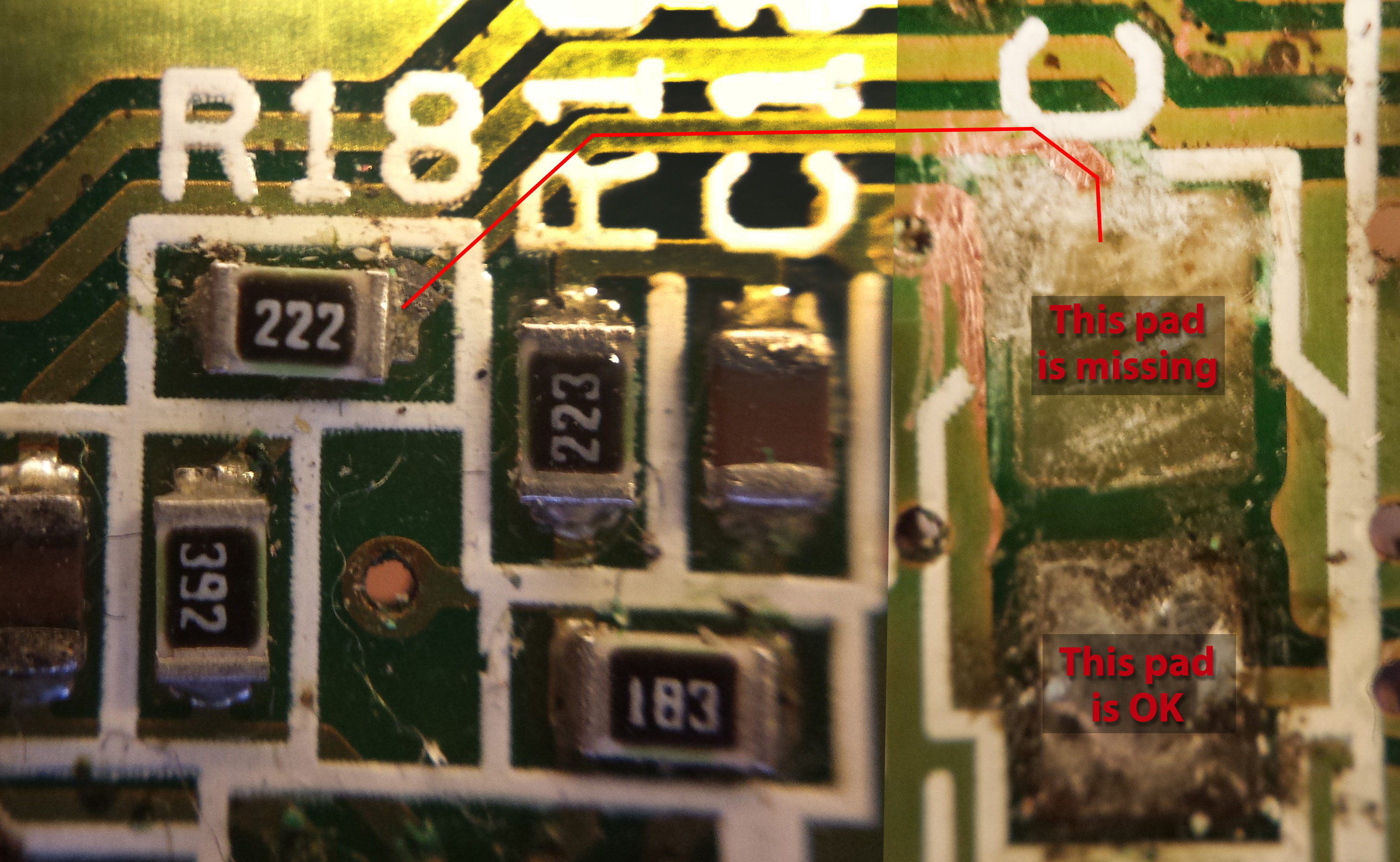

So here is the first of the two trouble spots. These are composite images because I was using a macro lens that can only focus on a small area. I drew a red line where I believe the pad connects to the trace and where it ends.
How would you recommend I fix this? I want it to be secure but it doesn’t necessarily have to be pretty. Could I, for example, run a wire from the leg of the capacitor straight to resistor R18 (with the code 222)?
Note that I'm replacing the surface mount capacitors with through-hole capacitors by bending feet and soldering them to the pads, if that makes a difference in how to best go about this. (I went with these because they looked easier to solder with the equipment I have, they were cheaper, and the vendor didn't seem to have the same size SMD's as the originals so I was worried they wouldn't fit.)

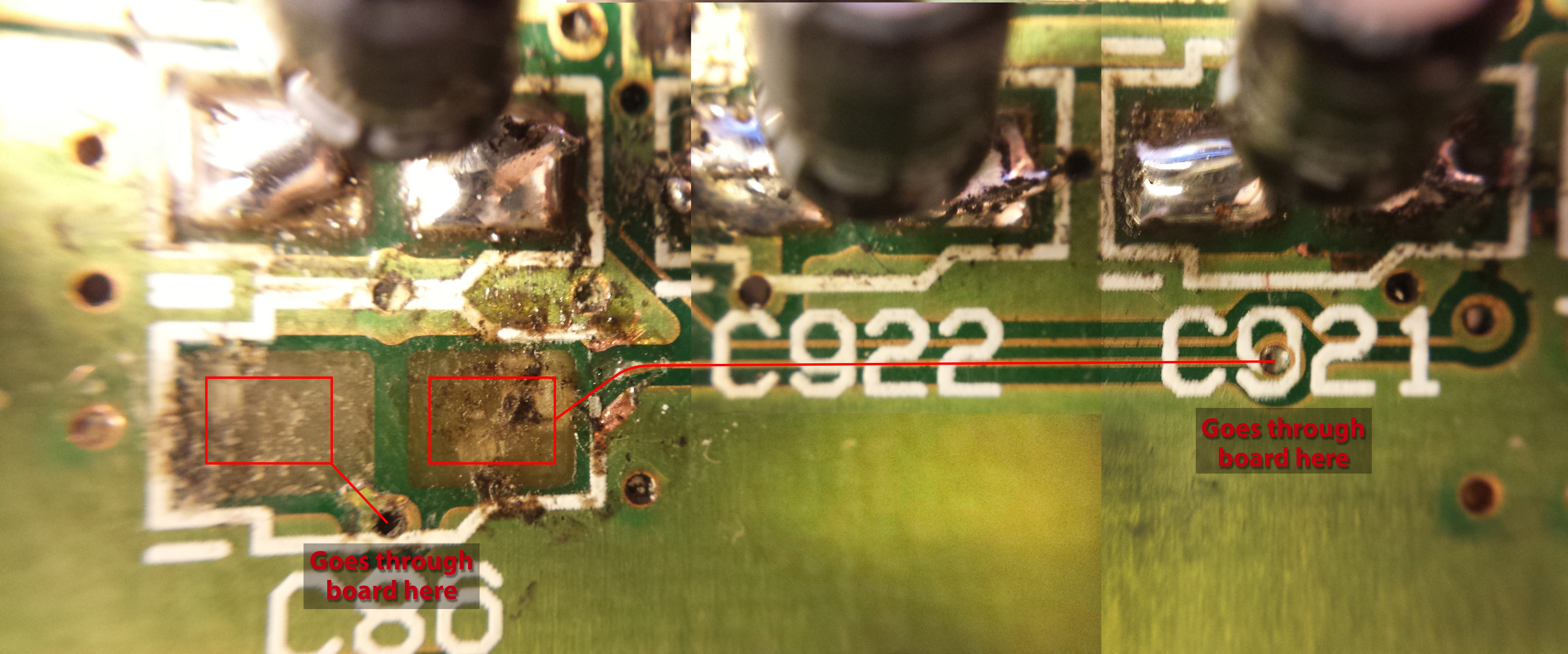

Here is the other spot, which looks trickier to me:
In this case both pads are missing. The negative pad on the left looks like it goes into the hole diagonally next to it. The positive pad goes over to the hole at the right. Can I solder wires directly from the feet of the capacitor to these holes? If so, this area is insanely tiny so I’m not sure how to best solder the wires there with the cheap soldering iron I have. Any advice on that would be helpful. Also I would need a way to physically secure the capacitor if both legs are solely connected to wires rather than mounted on the board. I'd rather not have it rattling around in there...
yup, that would do ..... supaglue the capacitor on it's side after soldering the leg to the good pad ( first pic) do you know which way around it goes (polarity)?
CLEAN up around that area first, as advised it's a mess
again I would glue the replacement cap on its side to the board, after soldering the negative pin down into the board through hole
Then just extend the cap's positive leg out, using some fine insulated wire, to the other through hole and solder it in
again, clean up all that mess before you start

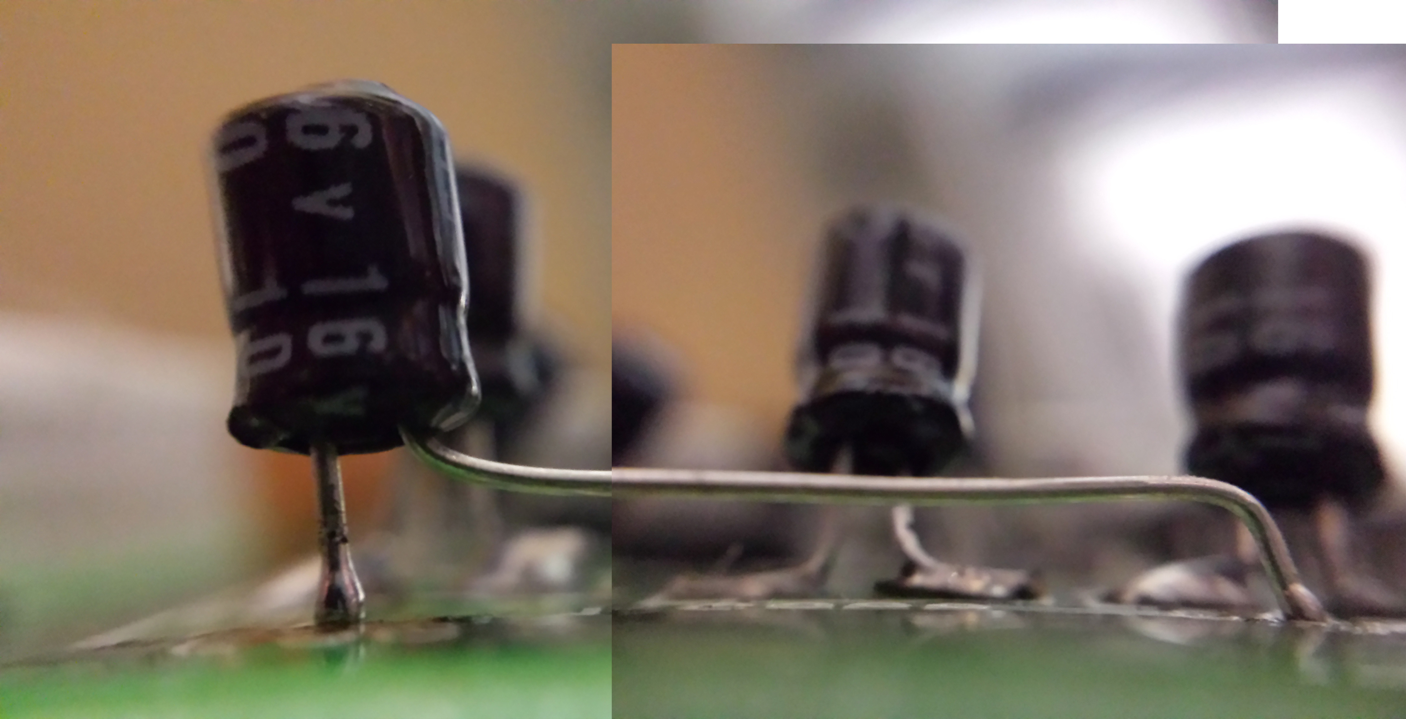

Here are photos of the two capacitors I fixed. Sorry, I don't have closeups of the other two that broke later.
Notice I used two twisted strands from a scrap wire. Is this acceptable?
This one I wired directly through holes that the traces went to. The solder seems to be in contact with the copper around the top of the holes so I think I'm good but I'm not entirely sure. I removed and resoldered it to be sure but it didn't change anything.

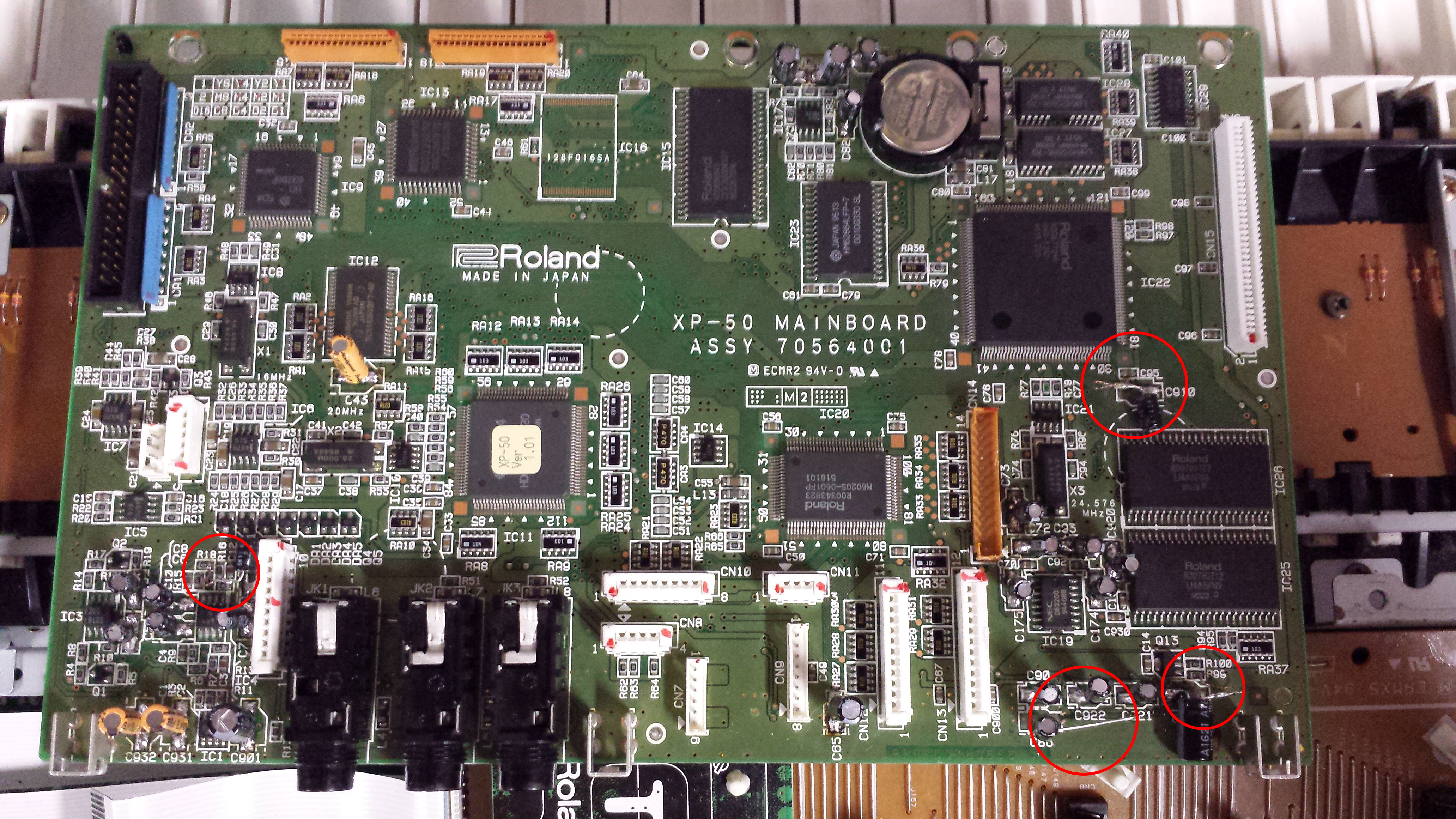

And below is a photo of the whole board. I circled the capacitors whose pads I had to fix.
Any thoughts on the above and whether my "fixes" need fixing, or ideas for what I can check next? I'm happy to post any other pictures or info if needed.
Side note on the capacitor I soldered in backward: This is part of the LCD control, which worked fine before and after I corrected the capacitor, so I'm guessing it is OK, and in any case not worth replacing to try to fix the audio. For reference, the capacitor in question is the yellow one in the far lower-left of the board picture above (C932).
Side side note: I made sure all ribbon cables were plugged in correctly, I tried new cables, using headphones and a mixer, multiple plugs on the mixer, and any other combination of troubleshooting to narrow it down to the board itself. I know the keyboard works because I recorded some notes on the built-in sequencer and the notes are coming in. It's down to the audio path on the board at this point, as far as I can tell.
