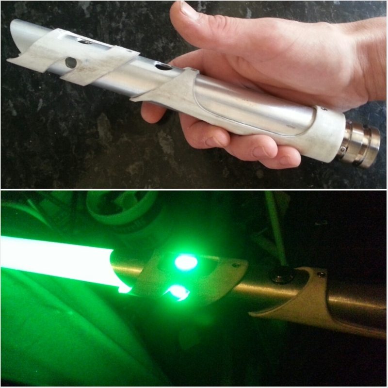

Here's a WIP pic of the last saber I made (light but no sound):

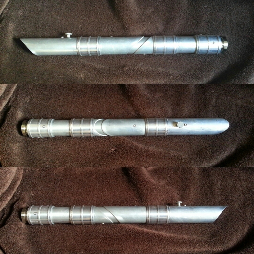

And my current build which I want to make the PCB for:
