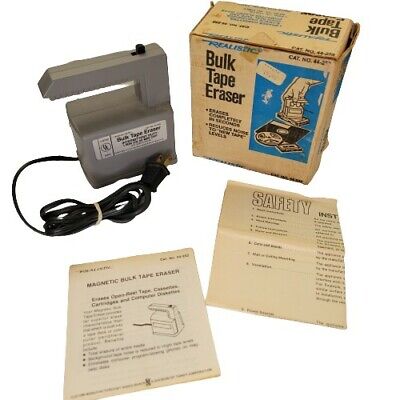

Hi
I live in the UK and I am looking for a way of creating the title matter. 'A Bulk Floppy Eraser'. I have looked online and there are a number of old products for sale usually tape reel erasers, these will do but getting them from the US to the UK is expensive, also buying new or from china at high costs area non starter.
So. I was thinking how difficult can it be to construct one, as I understand it, the media must be left in a neutral state, so simply wiping a magnet around a disk does not do the trick.
It should be a coil which generate an alternating magnetic field, and start as strong at it needs to be and then reduces its power over say 10 seconds to nothing thus eliminating greatly any magnetic polarisation on said media, in this case a stack of floppy disks I need to wipe as they have been used on different systems to the ones I want to use them on and the goal is to remove any magnetic residue/markers from them so they can be reused as they are simply not manufactured anymore.
So if anyone can come up with a fairly simple design, then I can make it. I just don't have any idea about building things with coils to so something like this although I'm ok with general electronics.
Any help will be appreciated.
Thank you

Hello,
Perhaps an old Radio Shack eraser might work:
For a more profesional solution have a look here:
Bertus

Hi Bertus,
Thanks for your replies.
The radio shack one has two problems
1.) It costs a fortune to ship it + Import duties.
2.) Actually just as important and probably more, over there you are running 110V we are running 240v. So unless it is a switchable supply that would mean buying a step down to add to the cost.
The Other UK one
Yes that would undoubtedly do it, but the price tag is likely too high. I might give them a call though.
I am just a hobbyist and just want to be able to zap old disks, so I don't need some expensive professional one.
Hence my original post.
I want to be able to make my own, and that's what I am looking for a design. If there is anyone out there who is able to create one, so I can make it myself.
In short, I know you need a core coil of wire around a calendar of some sort, and that effectively gets connected to the mains supply, but I guess I am just going to have to research it and have a go myself.
It was a long shot, and I appreciate your help.
Cheers - Gelpack.
