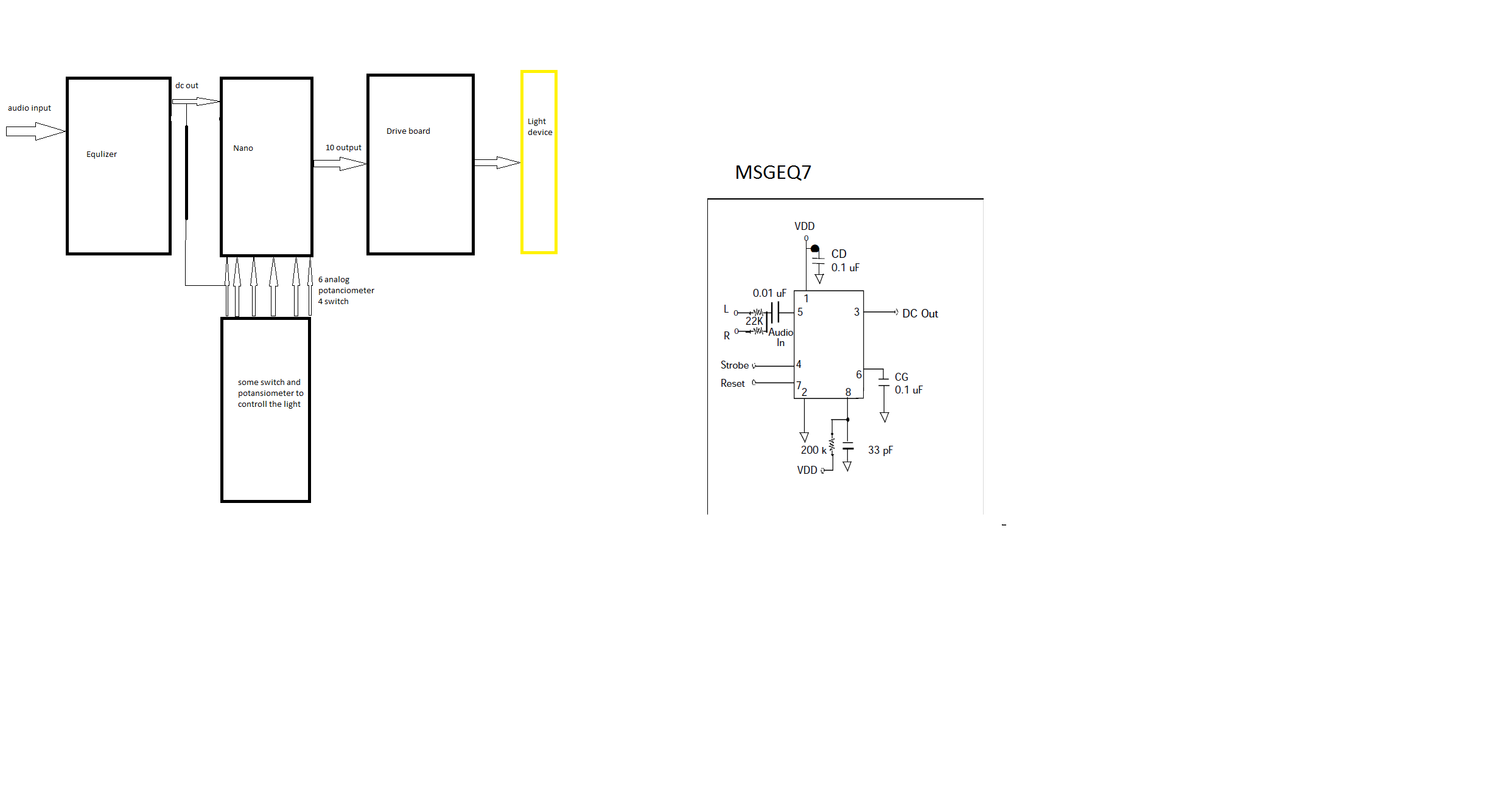

I want to use Arduino Nano as a decoder for MSGEQ7 and controller of light
does the whole idea make sense?

google "MSGEQ7" and "schematic"
You will get everything you need ! That how I got started with that chip !
You will even find sample sketches for the Arduino.
Keep in mind that people will help you up to the point where it seems like you are not making you own research !!!
