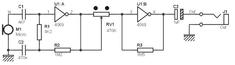

You can use CMOS HEX inverter's as an audio amplifier then with diodes, a peak detector, a Schmitt Trigger and a one shot all in one chip or use an Op Amp, transistor and a 555.
But the electret specs say the operating voltage is 2V drawing 0.5mA max from external pull-up Rs. The audio is then capacitor coupled out ( AC) to your amplifier.
So subtract 2V from your clean power source , divide by 0.5mA and that is the value for Rs.
(Vbat-2V)/0.5mA=Rs
e.g. (12V-2)/0.5mA= 20k or nearest value.
e.g. (9V-2)/0.5mA)=14k
An old link of mine can be simplified without pots, but if you breadboard and want to experiment with a 9V battery
http://www.electro-tech-online.com/threads/simple-led-circuit.145396/#post-1228906 Just remember to add the 14K pullup to your mic. to 9V.
The dotted line above contains all the parts inside the mic. and the outside is V- or ground.

Thanks SunnySky - that helped a lot. I can now see a voltage forming on my oscilloscope when I wire it up with the resistor. Problem is, I want to amplify it with transistors like in the circuit I linked to, but having no luck.
I really struggle with designing transistor amplifiers. Is there any chance you could help me understand how to design the transistor stages to get the mic signal amplified to provide a logic high?
I have tried to connect the output from the mic to a transistor - schematic below. That does light up an LED when I blow on the mic, but it doesn't amplify enough to light it up just from a clap.
I tried adding a second stage - schematic below - but this just lights up the LED permanently.
Can you advise me what I am doing wrong with this approach, and maybe help me work out a design which will light the LED triggered by a clap?
