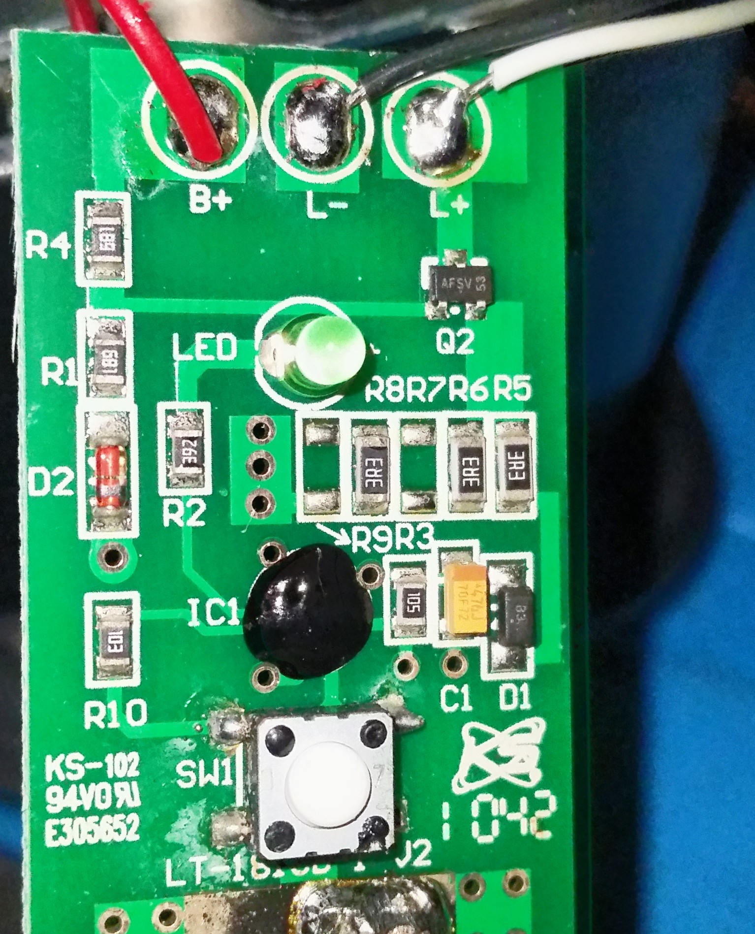

I have a lamp which takes three D-size batteries. It seems to have been designed to function best with alkaline batteries and is relatively dim (in fact the bright and dim settings both appear the same) using 1.2 V NiMH batteries. I was wondering what circuit I might use to increase the brightness of the lamp without draining the NiMH batteries below ~0.9 V to protect them from damage.

It doesn't use a bulb but three SMD LEDs which are connected in parallel.
This is the circuit that feeds the LEDs (there are no other components on the board with the LEDs). I figured the simplest thing to do would be to add a circuit between the battery and the original circuit which would boost the voltage to 4.5 V but I need it to cut-out at ~2.7 V supply to protect the cells. Would such a circuit continue to use power whilst the lamp was off, though?

The battery compartment is designed for three. A fourth cell would be an awkward thing to add to the outside of the case and I think would leave the cells vulnerable to reversing polarity during discharge, plus the voltage might be too high when freshly charged? It would also no longer be waterproof (I bought it for camping although it's probably seen more indoor use than outdoors).
I have a voltage boosting module that will maintain 4.5 V output while input drops down to ~2 V but that's still risking reversing polarity if my cells aren't well balanced. I regret buying this lamp!

4.5 V is the voltage I want to run it at. I never said I want to run it higher than 4.5 V.
I tried a cheap variable voltage boost module set to 4.45 V and it seems to work pretty well. I was originally worried about accidentally overdischarging the cells but the lamp begins to flicker when the cells are nearing depletion so there's clear warning. The lamp is now very bright but the battery doesn't last long. They're fake D cells which actually just contain AA cells and air. Real NiMH D cells are pretty expensive though and relatively hard to find.

I mentioned a voltage higher than 4.5V because a Ni-MH cell is 1.4V or 1.5V when fully charged. Its voltage drops to 1.2V after discharging for a while. Then if you boost the fully charged 4.5V to 5.6V the circuit might smoke and burn.
You need a regulated 4.5V from the booster that still passes 4.5V through it.

Fresh alkaline batteries can have a voltage of 1.65. I'm not concerned. The voltage from the booster will not go above 4.5 V unless more than 4.5 V are supplied which is not going to happen.
