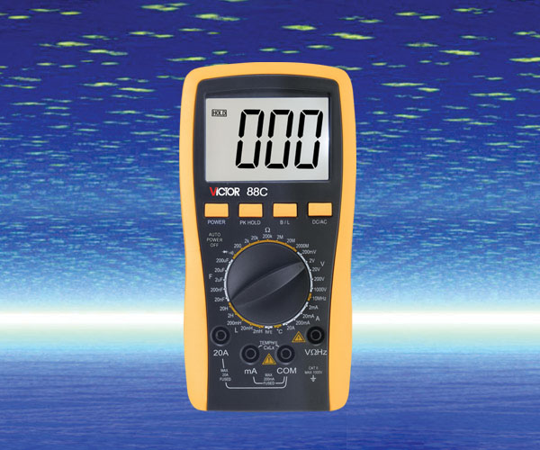

I broke my multimeter(Vİctor Vc88c). Everything is working charm except temperature. Multimeter display wrong temp. Like -250℃. I am not measure temp often but i want to repair if its possible.
So I didn't find my multimeter scheme on the internet. I found two multimeter that has similar technical properties. I think vc9805a and ut70a are look like my multimeter. And ut70a inside looked very similar to me. What might be the problem? I want to know which part of the schemes are related with temperature measurement. Need help. Thankyou...

It looks like the temperature probe connects through the µA/mA connector. Check that the fuse on that connector is not blown. I have no other suggestions.
dark phobia
Dec 22, 2014
6
Dec 22, 2014
6
I have only this multimeter so i can't measure. I calibrated the temperature vr5 and vr6 -320℃ at room. I measured hot water as 397℃. Multimeter working reverse but i think it is enough.
When i connect to 1k ohm resistor to R17 reading temperature is get better and display +30℃. I have no smd resistor now i will try to change after i got.
There are lots of ways to check a fuse without using a multimeter. In this case you can check it by (a) connecting your temperature probe, selecting the temperature range, and bridging the fuse with a pair of pliers - if the temperature indication comes right, you know the fuse is open, or (b) checking that the multimeter can measure current on the µA/mA range.
