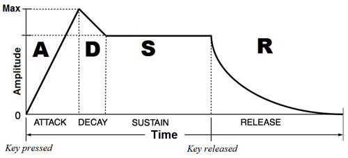

Hi All,
I have a 64 key electronic piano and as you play a note the note stops playing the instant you release your finger. This doesn't sound right at all, I have a sustain pedal which I can set to NC but this puts too much sustain on the notes and they being to blur together. o_O
Adding resistance to the sustain pedal doesn't seem to have an effect.
Is it possible to modify the keyboard itself so the notes have a small decay time by default? I just want a more natural flow between each note being played.

I doubt you'll be able to modify the piano the way you want, unless it's a prehistoric one with analogue circuitry defining the ADSR envelope. Most instruments these days do things digitally, so any mod would require software changes.

Now you've mentioned envelope.. It appears I meant release time according to this graph. The decay once the key is released.
It's a shame though, most cheap keyboards are the same. Maybe I'll have to save some pennies.
