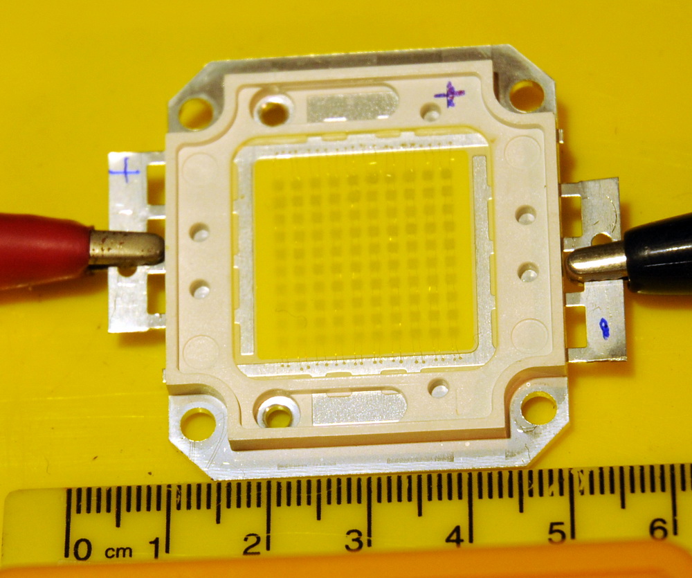

I've got two different 100 watt leds:
#1: 100 watt, 20 - 22v maximum forward voltage, 3500mA maximum forward current
#2: 100 watt, 34v maximum forward voltage, 3500mA maximum forward current

My goal is to operate these LEDs at about 80% of their maximum threshold. My plan is to buy two power supplies, one for each led.
Can you help me pick out a power supply for each of these leds? I'm learning but want to make sure the choices I make won't burn up the leds.

After doing some more reading, I believe I need a constant current driver. There is no resister build into these LEDs. It's just the module itself.
At least that is the best guess I can make right now given my understanding.

That's the thing. I know that they can handle a maximum of 3500mA. I am thinking I would want to control that current output, right?
The only other thing I need to watch out for is to make sure the power supply puts out enough voltage, right? Am I worried about too much voltage?

The drivers will have control actions that sort all this out for you. They are generally quite wide input ranges (from 90-265VAC) and will ensure that the output always stays at the right level.
You must choose a driver that matches the driving characteristics of your LED's. Some drivers will even have controlable parameters that let you chose from a range of output powers.
With LED's voltage can vary a little (and i mean a little) but current must be strictly controlled. This is because unline most devices LED's will draw more current that they need until they fry. This is kind of like a zero resistance effect where the current will just rise indefinatly until the device is destroyed.

This makes sense and is getting to the root of my concern. I would assume if I want to drive these leds at some threshold below their maximum rated forward current I should choose a driver that outputs currently below 3500mA? Is that the right way to interpret maximum forward current?

Yes exactly. The current is what illuminates the LED and therefore lowering the current will lower the brightness of the LED's.
All LED drivers can be thought of as constant current supplies as this is the most important controllable parameter. Therefore they are designed to ensure the LED's operate correctly and buying one off the shelf should require no external circuitry for operation other than the wireing to and from power supplies and LED's.

You just need to choose a supply that can supply a little more than the forward voltage and the current desired. Operating them in constant current mode is the right way to go.
By the way, how many lumens do these put out? At 100W they ought to be seriously bright!
Let me guess, grow lights?
