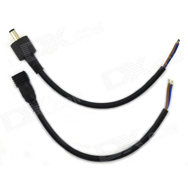

I would just replace the "tiny" connector with a larger barrel type DC plug and replace the jack on the 12V 2A charger. Then all you need to do is wire the two wires from the jack to the same place the two wires from the old jack were wired.

to solve the problem, get a female power plug (or even a 3mm audio jack) and solder on the pins for the power (assuming the charger is two wires... or just use a 3 wire one... in any case, be sure to use the inner most portion of the pin for what is in the inner pin of the charger)... then replace the plug in the charger for the matching plug you just installed. and pronto. now your mom will have an ugly short power cord sticking out of the tablet, but much easier to use.
also, try to hold the cable on the case, so it is not the solder holding it. hot glue is probably fine.
