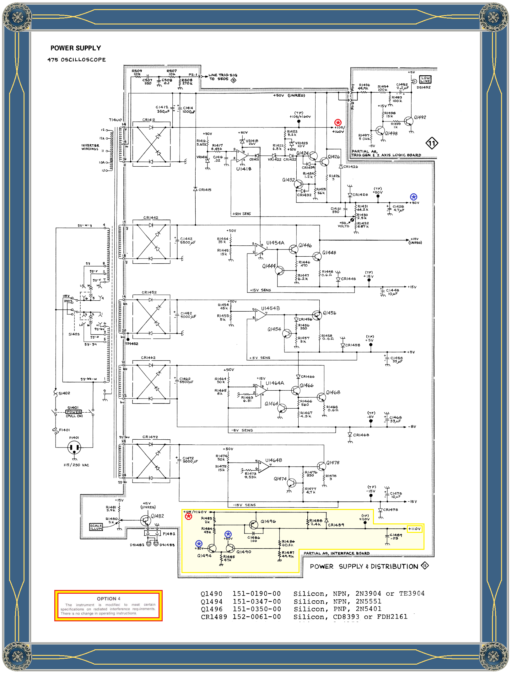

I'm trying to restore the oscilloscope Tektronix 475A Option 4
I found on the Internet a good documention for the oscilloscope 475
However, my instance is different (Option 4)
I found documentation on the opton 4 circuit but it is of low quality
Can you send me a picture of a 110 volt channel circuit ?
My instance has Q1497 transistor (protection of Q1496 current)

Sir Global 111 . . . . .
O.K. you can forget worrying about the Option 4 design aspect of that unit, as I am certain that you are not going to be one of the very-very-very select few (x the power of 100) that would be be needing the additional RFI and EMI suppression of that unit unless being in a RFI EMI anechoic chamber / screen room and, even then, be using its DC powering option.
So this Option 4 unit is giving you MORE radiation suppression than the common version does.
As far as the units + 105V supply , it is tied / interlocked into some adjunct supplies being active also as I have marked it up on the schematic..

Hm maybe I was wrong about Option 4 (Maybe other option ).... I need circuit wit current protection on Q1497

Sir Global 111. . . . . .
NEW SUPPLEMENTAL SCHEMATIC . . . .
On the supplies specified schematic just below, note that the Q1496 is being the primary
series regulating pass transistor, with a Q1497 being a current sensing transistor in its base circuitry and the Q1494 and Q1490 being go-no go sensing of the 50 V supply presence.
PROBLEMS. . . .
If you have problems with Q1496, it could try to not regulate and pass the full +136 supply voltage thru to the +110 supply . . .or . . . . a crunched C-E junction on the Q1497 could do the same thing.
With Q1494 and Q1490, being so highly resistively isolated, they are being more bullet proof.
THEN . . . . .
Find the schematic page with with CRT support circuitry on it and observe the top left corner, where the +110V supply feeds in, and then the immediate Q13XX + CR13XX series related parts that it feeds for Z axis circuitry.
See if any bad parts there are responsible for a shorting or excess current pull of your +110V supplies power input feed.
Its 4 different supply routes being fed, are being shown on the schema snippet.
Also, poor bypassing being provided by a main E- filter(s) could also be at fault, at the +50 and +105/+160 source of their raw DC filtering . . . . .C1412 - C1414 - C1428.
