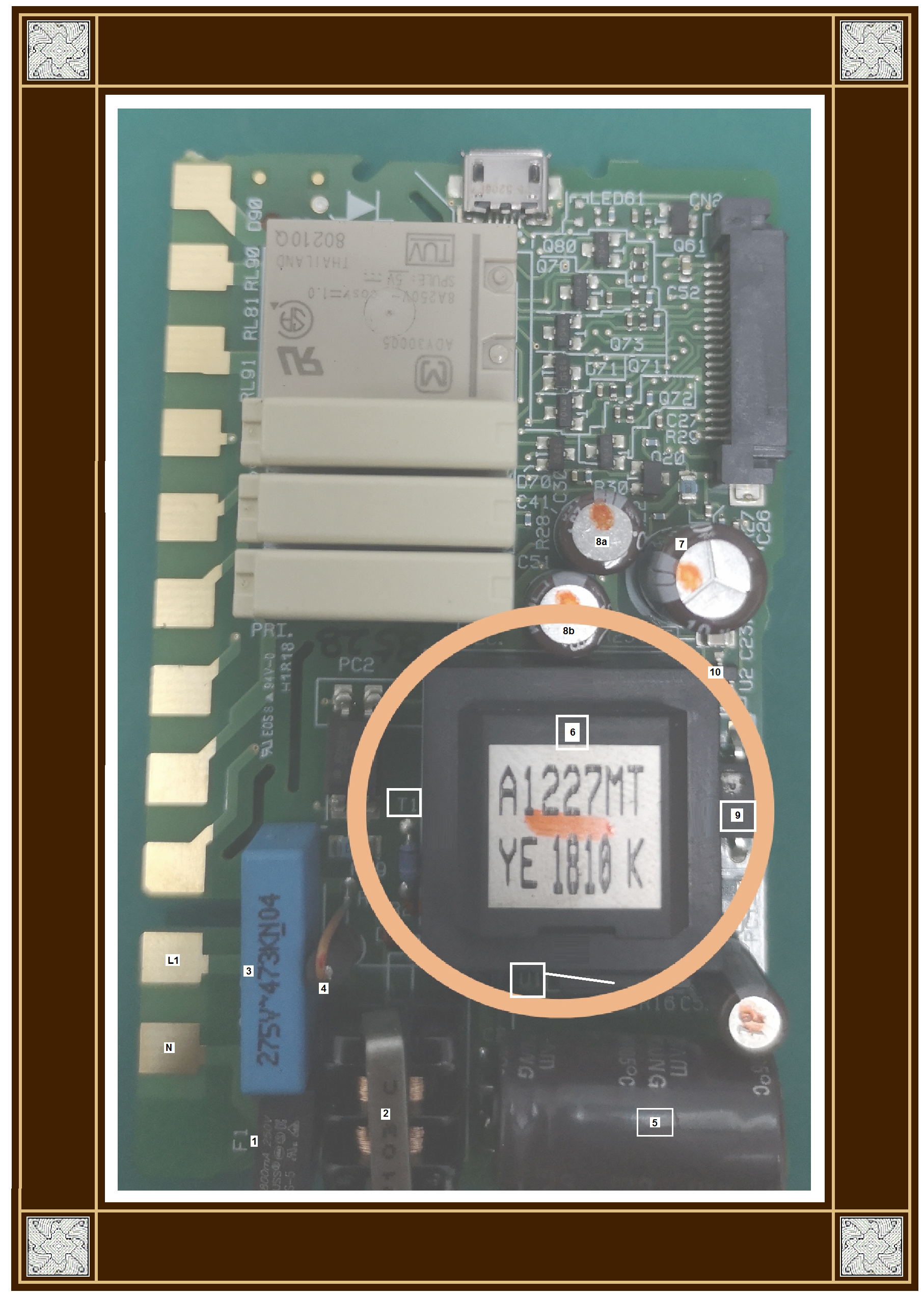

Hi there, I am a newbie in electronics repair and in the midst of troubleshooting a power supply board for Yokogawa UT35A PID controller that experienced over voltage. The unit is rated between 110 - 230VAC.
During my observation, I have found a component which I am not able to identify. Linked a photo of it, appreciate if someone can tell me what is it and where I can source it online.
https://ibb.co/CPRpBbY
Many thanks.

Hello,
Looking at the silver sticker on the part, it must be a progammable device.
Without the code inside, you are out of luck.

Big cap and mains input choke on bottom, opto on the left side, caps at top, I'd agree with Audioguru.
Especially since there is T1 written on the left hand side.:):)
Rarely , if ever, are these found as faulty in an smps.
How is the fuse on the left..?? (F1)
Just be aware some of these units require external components/circuitry to enable start.
Do you have a photo of the other side?
Excellent photo for diagnostics by the way.......care to share your method?

Sir LP640 . . . . .
Initially . . . just an utilization of a bit of digital and optical prestidigitation to optimize for maximun perceivabe resolution / interpretation of that partial photo submitted . . . being viewable better in critical areas, without that LARGE of an ORANGE circle
Seems like the HOT A.C. (Line 1) input is at the 2nd gold flashed PCB finger connection at the bottom left corner of the PCB. Its foil then routes up to the top terminal of the BLUE X capacitor and is afforded further electro - physical isolation by the two routed out slots in the PCB proper, located just above. The bottom lower gold flashed PCB finger connection is the N . . . . .COLD input side of the AC line.
And then it gets afforded a bit more anti EMI-RFI treatment with item [3] a special X capacitor of 0.47 ufd @ 275VAC rating.
The HOT AC input foil then further routes down to a series, low resistive value, input surge resistor item [4]. Then its into and out of the line choke [2] and into an ? unviewable ? fulll wave bridge block rectifier or being made up of of 4 discrete diodes, if so arranged.
( It / they must be physiclly located in the unviewable area, just below the LARGE side mounted E-cap. item [5] )
The outputted raw / unregulated DC voltage, is being of either . . . .160-170 VDC if ( Amerikanski/Japonie ) or 340-360 VDC if ( You Are A Peeing ), is being accumulated and smoothed out within the BLACK ? item [5] main E-filter.
That main HV filters output voltage then feeds over into the primary of your purportedly ? MYSTERY ? Black T1 Switch Mode Power Transformer as being item [6] .
With me being unable to see its foil path, somewhere, being series inserted either before or after passing thru the item [2] a contra-phase wound (phase cancelling) RFI- EMI filter choke in the AC power input , is being the bottom left corners item [1] chemical fuse. . . of a 800ma-275VAC rating.
All of the brains and accomplishment of switch mode drive generation and feedback / regulation control is being accompished within the UI power integrated circuit, positioned at the frontal foreground of that transformer and is so designated, as its being " U1 " nearby.
At the topside of that transformer is /are its secondary winding (s) output (s).
With your big ORANGE circle somewhat blocking view PLUS my not being able to "read" the boards bottom sides other foil paths.
I will now just opt to speculate the potential / possibility of the T1 transformers adjunct right side mounted diode . . . item [9] being used for creating the main low voltage output for that transformer, and to then be fed up the board to the largest E-cap item [7] for its filtering .
I suspicion the the two adjunct companion E-caps . . . items [8] [8a] might be for additionally derived lower voltage supplies.
Compare the voltage ratings specs on all three caps to be able to differentiate that possibility..
Two other unidentified sitting ducks are the transformers top left corners PC 2 which is for feed back of the outputted DC back to the U1 main IC, being used for regulation correction between a hot AC supply and the cold transformer isolated outputs supply.
At the power transformers right top corners U2, item 10, might be a related type xx431 series adjustable zener voltage reference.
At the boards VERY top left corner, I see one HEFTY power relay, with its 5VDC coil and and 8A/250 V rated contacts .
Additionally, located just below it, are being 3 separate minor relays (they have the casing profile of being reed relays) , as are used for lower power level switching.
TESTEE . . .TESTEE . . . ? ? ? . . . . . HOW DO YOU TESTEE ?
If you power up and test across the side terminals of the side mounted item 5 E-capacitor and find one of our prior mentioned voltage levels . . .all is possibly well with the units basic DC supply.
Then its being a question as if the switch mode aspect of U1 POWER I.C. is working.
A DVM in its lower DC voltage range and metering across Transformer associated secondary E-caps items 7 and 8a - 8b should show a supply voltage presence on a working unit.
