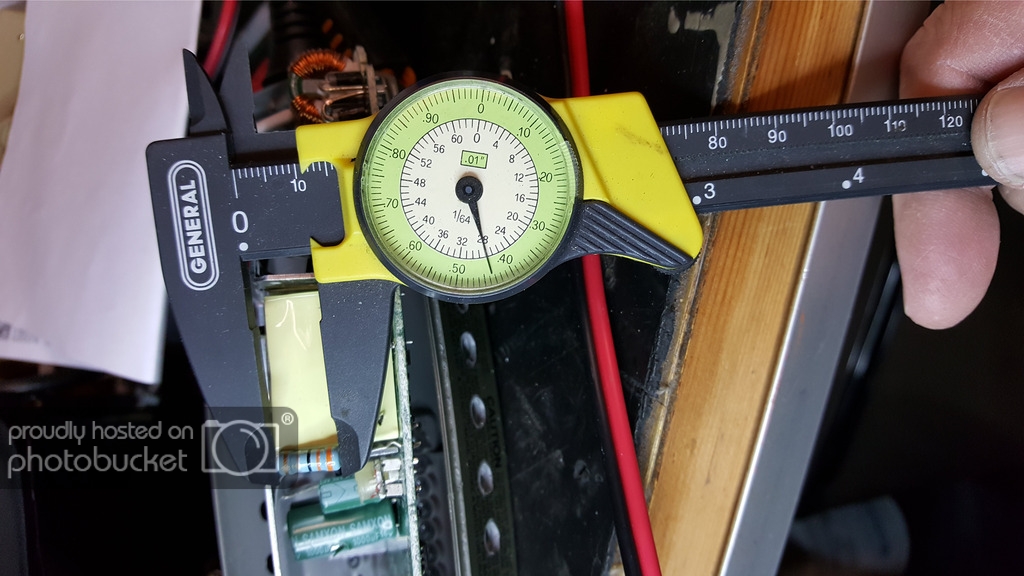

Hi guys. I am an electronic n00b here and while modifying the case of my cool new battery charger to add cooling vents (I felt that the charger running around 140 deg was a bit too warm), I slipped with the drill and unattached a leg from the pictured resister. I have put in 2 separate orders and have received 2 incorrect products. The first order attempt was my fault as I ordered the incorrect ohm variable (33.3ohn instead of 3.3ohm). For my second order, the units I received were approx 1/4 the size of the one i need replaced. In a humble attempt to stop this nonsense, Im seeking some help identifying the below resistor. If further measurements are needed, I can take more pictures and post them up. Thanks guys.

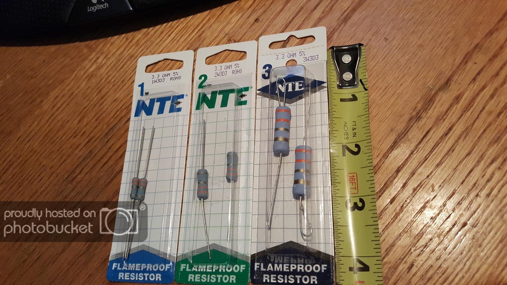

^ the resistors that were sent are 1 watt

I think the resistor you need is a 3w maybe 5w but i think 5w come in ceramic cases?
Colin Mitchell
Aug 31, 2014
1,416
Aug 31, 2014
1,416
The resistor shown above is 3.3 ohms
You can use 1, 2, or 3 watt as the resistor doesn't look like it is getting hot

Will it hurt to put a higher wattage resister as a replacement? Here are the current ones that I have ordered and received.
davenn
Sep 5, 2009
14,487
Sep 5, 2009
14,487
Note the grey body represents flame proof .... meaning they are not supposed to burst into flames when they get cooked ( over voltage or current)
your original one is a blue body, which signifies high voltage rating
a higher wattage value doesn't matter, just means the resistor will run cooler

additional note
the grey bodied resistor pic in the first post is 33 Ω which is not suitable
