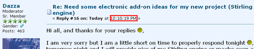

Audioguru,
The forum clock displays the time acording to your current time zone which you can change in your profile settings. ;D
