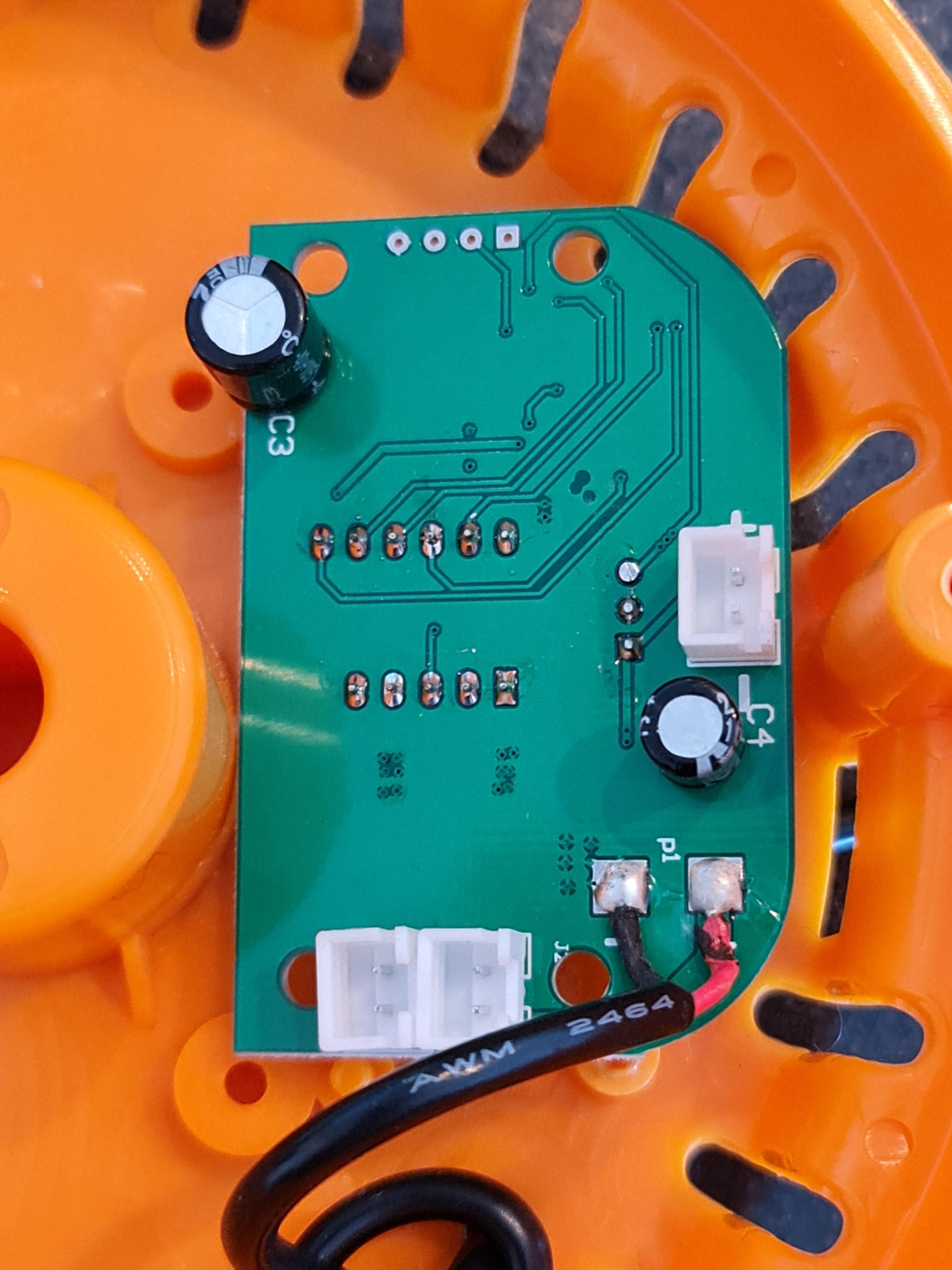

That looks like an interesting torture device. A twin turbo vibrator.
It’s probably a micro controller with built in (programmed) speeds with a tactile switch.
Can you take close up photos of both sides of the PCB. Do the motors have any writing on? Like voltage?.

Measure the voltage to the motors, it may be 12V. In which case you could run it direct from the adaptor and a timer/smart switch.
I wouldn’t run those cheap motors for too long though, keep an eye on temperature. You could add a PWM motor controller.

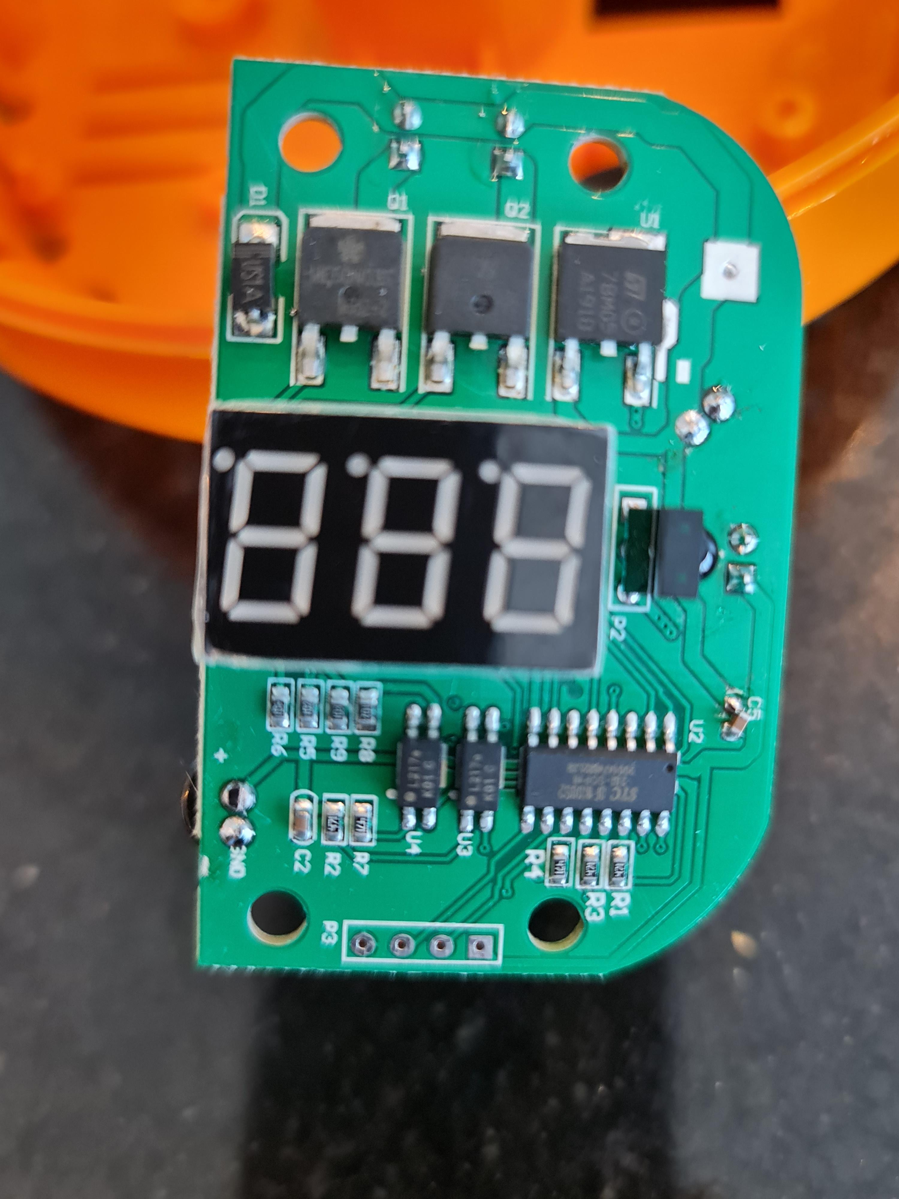

Here is the PCB:

No. Put the probes on the motor connections while powered.
It may already be PWM. I can only read one IC. That is a 5V regulator (U1).
Can you read Q1, Q2, U2, U3 and U4.

0.0-2.8 volts DC. It fluctuates.
I put it back, but if required I can take it apart to read.

Fluctuating suggests PWM.
The IC numbers will be required to see if there is a work around.
But you can buy very cheap motor controllers that you can adjust for that very special night!.
