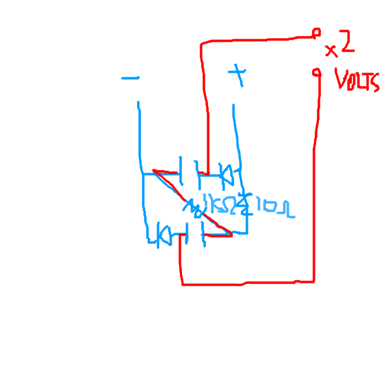

I've been working on my own design of voltage doublers/multipliers. The circuit here is a times 2, but you can add more caps to it easy enough for more voltage.
The idea for how it works is the capacitors are charged in sequence by the DC power supply, the first capacitor is shorted to, then once its filled the current diverts to the second capacitor. They must be charged in sequence, or they wont be filled to the top for times 2. If you charge them both at once they only half fill.
The diodes are there to stop the capacitors from discharging, the resistor values are to make sure voltage division doesnt cause too much loss on the collecting voltage.
Then they discharge in series, giving you a similar effect to batteries in series, they add their voltages together.
The circuit is tested and working, except for a strange problem I need help with.
I only get twice the voltage, if I turn the power supply off then test it. I know that I have to wait for both capacitors to be full before I test, this isnt the problem, it seems with the battery connected it only reads the volts of the power supply not the capacitors!
Note: I actually dont remove any leads, just switch the power supply off and bam I get double the volts, but when its on, its only registering the normal voltage, im not sure what it is!
The discharge path is open, and im just measuring both sides with the multimetre, with the megohm impedance or whatever the only thing connecting it.
Its completely tripping me out, not sure what to do.

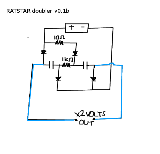

Heres another version of the circuit, and its just doing the exact same thing.
The blue is the charge. (and unless I remove this charge, I dont get twice the volts on the serial discharge.)
The red is the serial discharge.

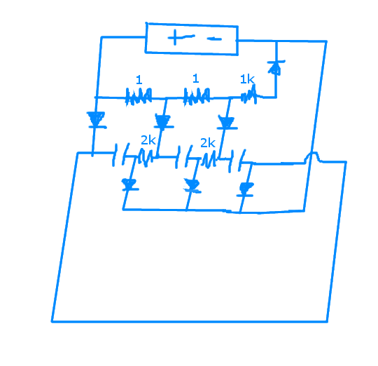

I made a 3 cap one, the voltage reading isnt above 30 volts! but im getting small numb electric shocks from it (im using electrolytics so i can get voltage readings.), maybe im not reading the voltage right.
When I read the caps one at a time, I do get the full voltage each time, but I cant seem to measure them together.
Is having resistors in the discharge line confusing the multimetre?

heres the 3 cap one's, schematic. I cant get a collected voltage reading, I wonder if its the 2k resistors confusing the meter??
When I read the caps separately they are all near the full 30 volts, and I was feeling a bit of the electricity in my fingers.
Think of the diodes as stoppers on the capacitors so they cant discharge,
and the resistors are controlling the path of the electricity, and also making sure the voltage division ratios are acceptable.
Heres the 4 phases of the system, It charges the capacitors one at a time, and thats how it achieves the high voltage.
AB
CD
Harald Kapp
Nov 17, 2011
14,317
Nov 17, 2011
14,317
You cannot be helped: these circuits will not work with DC.
In order to have current through the capacitors, you will require an AC source. Otherwise the capacitors will charge once and then stay at this level without any further change in voltage across.
You discharge it through a spark gap, then it just charges again, over and over.
Its the same as a spark gap oscillator. (Only needs DC,)
It is still rectified oscillated AC out. its like PWM sorta.
