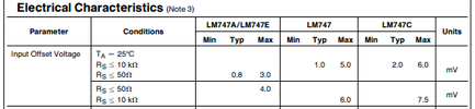

Hello,
An ideal opamp would have zero input current.
The LM747 has an input current between 80 and 500 nA.
I do not know what current is used as input current by LTspice.
Bertus

I get the following -
The NSC datasheet shows -
The markers closest to opamp inputs are current measuring, all the others V.
You are seeing offset and bias currents causing offsets flowing the 660K ohm R's

Ok now i understand if i take a higher input voltage of 10V the output value is now 10.04V
Harald Kapp
Nov 17, 2011
14,317
Nov 17, 2011
14,317
That's to be expected as the gain is 1.00378.
When you replace the OP747 by an ideal opamp, e.g. UniversalOpAmp from the LTSPICE library, you get 2.005 mV in your first example. This clearly shows the non-neglibible effect of the input bias current.
