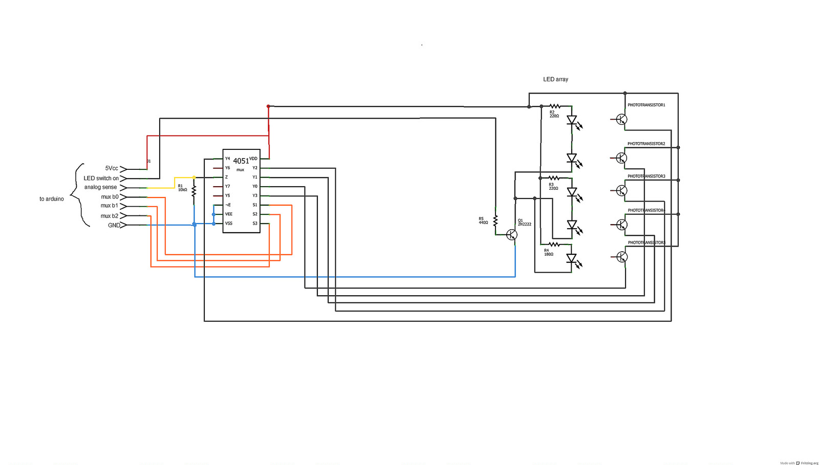

It might be a bad idea, but I want to get this to work in the visible spectrum. I hate buying invisible lights, and I'd also like to use these components for other things later
If you want to use visible light, you should make a baffle in front of the phototransistors, to reduce their 'angle of sight' and to dampen the ambient light.
It might in fact be a good idea to use phototransistors with a base, so you can reduce and bias the sensitivity if necessary. If you want be very fancy, you could measure the ambient light and compensate for this in the phototransistor's amplifier.
Regarding the card, and the clock row. If you use a fixed clock row, you will weaken the card and make it fragile lengthwise. If you use a coding sequence that always have a hole punched for each code position, this would not be necessary. You need to do some calculation but your card will be more solid.

Update: I have since built this thing, and it actually works!
Here is the final schematic. I thought I'd use one of the 4051's I bought by accident, just to make it all look fancy, and also to save four analog-to-digital pins.
I did a bit of a cheat to attach the voltage divider resistor to the 4051instead of using 5 of them on each phototransistor, because I am stingy. I'm not sure if this is to be frowned apon, but it seems to work.
I have a bit of a problem with the ambient light levels, but that could easily be solved by having a moving-average filter on the values (right now I have just thumbsucked static threasholds)
If you're interested, I'll take pictures of the thing in operation, and post them here.
Thanks for all your help

You could also add a separate optotransistor to measure the ambient light and use that to make an automatic threshold adjustment to your hardware, or measure the value and adjust your ADC readings accordingly.
Good work. Multiplexing the channels will only reduce the maximum reading speed. If you can live with that, no problem.

Looks great.
You should cover the behind of the optotransistors. The ambient light will filter through the plastic from behind. Or you could paint them black on the lead side, to reduce the false light.
