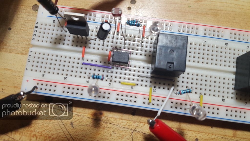

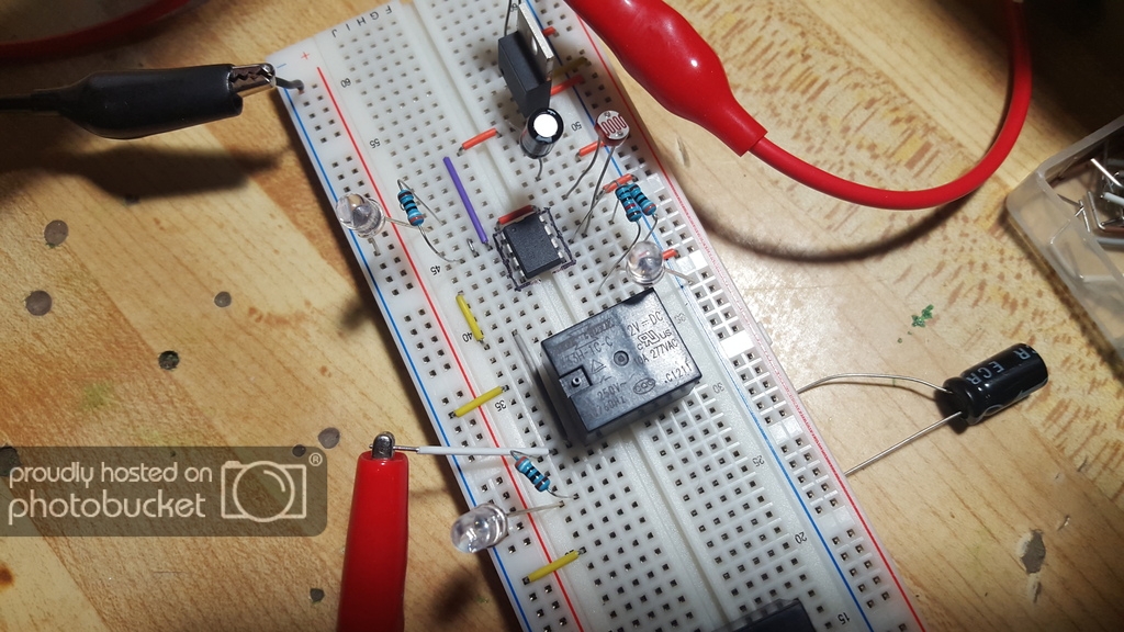

So im having a little trouble understanding variables with Picaxe. I have read the manuals and watch some videos and just still confusing to be honest.
So im using the picaxe 08 chip. Basically all im trying to do is use a photo cell that will have a constant laser aimed on it. When the beam is broken I want it to trip a relay on for a certain amount of time
Now Ive been told by a member here on the forum that a photocell will have to use the readadc command, which I am but Im just not completely understanding how to use variables.
So can anyone help me out here?
So here is the code I have so far.
Code:
main:
    readadc c.1,b0
    if b0 > 50 then high 4 goto ldr1 endif
    if b0 < 50 then low 4 goto ldr2 endif
    goto main
ldr1:
    high c.4
    wait 5
    goto main
ldr2:
    goto main
And here is a video of what its doing so far,
Here are a few pictures too.

Ah yea sorry.
Basically I cant get the phtotocell to work at all.
In the video I made you can see me covering the photocell and the LED goes out but at the end of the video you will
see my DMM and it doesn't go to 0v at any time.
Thats what I dont understand though. I dont get the whole b0,b1,b2, etc and the variables you set for it.

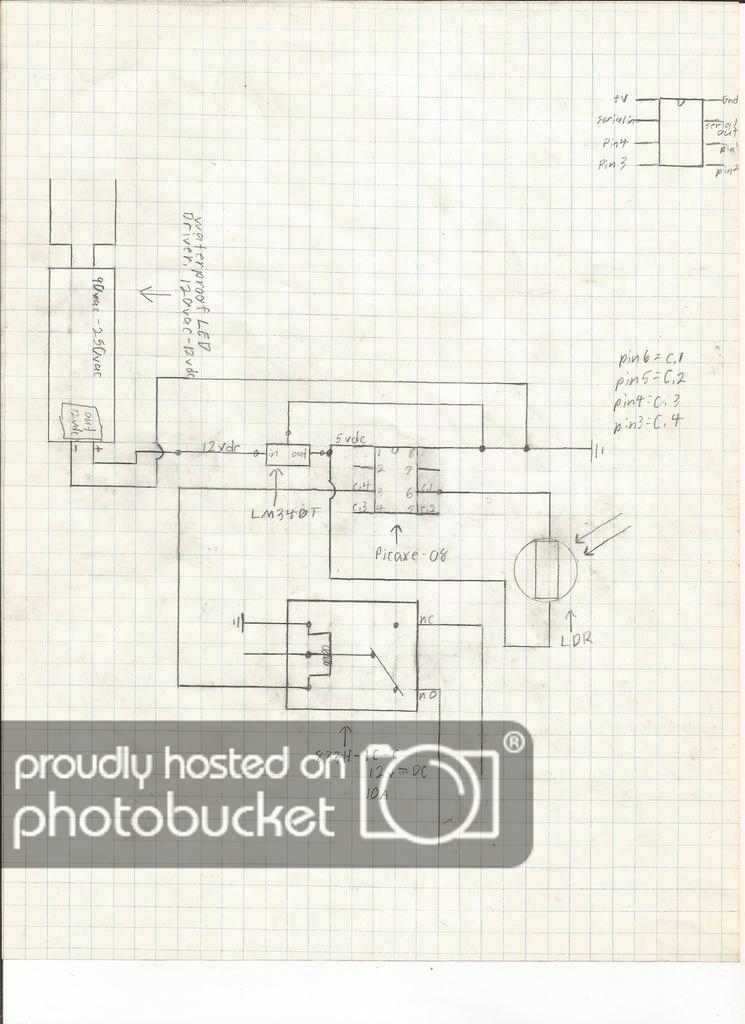

Here is a schematic for ya.
The LED's are not in there and also the caps that are before and after the voltage regulator.
But just so you know, there are 390ohm resistors in series with the LED's. On the voltage regulator there are 10uf caps on the input and output. There will be a 1uf on the input when it it arrives.

I was afraid your circuit might look somewhat like it does.
Your LDR is in series from Vcc (+5V) to teh input of the PicAxe. Assuming an input resistance in the >1MΩ range, any change in teh LDR's resistance will be negligible compared to the input resistance. Therefore only a very small current can flow and the main voltage drop occurs across the input resistance of the PicAxe. This leads to what you experience: only a very small change in voltage on the PicAxe's input pin when the LDR changes from light to dark.
You need to add a resistor from teh PicAxe's input to ground with a value less than the dark value of the LDR. Read this information to bring you up to date on LDRs.

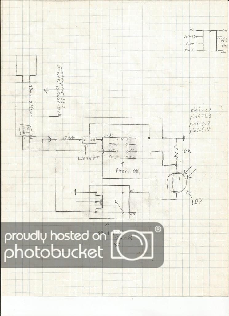

Hopefully this will be a better schematic.
I forgot to draw this in.
I will measure the resistance of the LDR and get back to you.
Harald Kapp
Nov 17, 2011
14,317
Nov 17, 2011
14,317
Much better. And the resistor is in the right place, too.
Depending on the type of LDR, you should expect a value in the 10 kΩ range in the dark and <=1 kΩ when lighted. If this is the case, 10k for the resistor from pin 6 to ground is a reasonable value.
The voltage on pin 6 should vary between ~5 V and ~2.5 V. If you want it to go to less than 2.5V, make the resistor smaller. The resistor and the LDR form a resistive voltage divider which you can adapt (within limits) to different voltage ranges at the output.
There is one issue that might be resonsible for you not seeing a reasonable change in voltage between light and dark: the multi-purpose operation of the PicAxe's I/O pins. If pin 6 is programmed as digital I/O, it may override whatever voltage is applied externally.
Make sure in the setup of your program that pin 6 is programmed for ADC input and not for output. Unfortunately I cannot tell you how to achieve this as I'm not familiar with this processor variant.
A note on the side: Add a small capacitor (10nF or 100nF) parallel to the resistor from pin 6 to ground to increase noise immunity.
You should also place a 100nF capacitor from the Vcc pin of the PicAxe to the ground pin as close as possible to the chip and an electrolytic capacitor (e.g. 100µF) at the output of the voltage regulator (5V) won't hurt either.
