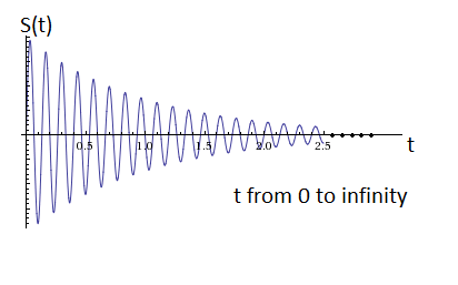

First of all, I have to calculate power spectral density S(jw) of this signal:
It looks something like that:
t>=0
But it seems to me, that I can't use this standart formula:
So.. I see that there is signal multiplication- exponent and sinus, but still not clear how to get spectral density S(jw).
Any ideas?

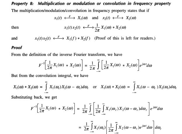

Now I'm trying to find solution in other way, using this property:
I think that I can try in this way, because s(t) is multiplication of two signals.
S1(t) = U*e^(-a*t) and S2(t) = sin(w0*t)
What's your opinion?

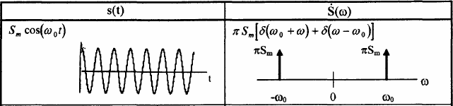

I found out, that we can't just use standart formula, because a sine wave spectral density has only a delta function at the carrier frequency since the signal contains just
one spectral component namely the carrier frequency.
Here is something simular, but there's used cosinus.
For now I haven't got ideas, how to continue this task. Of course I'll try to think something.

Sorry, that's only partly correct.
Right, a pure sine in the time domain evaluates to a delta function in the frequency domain.
But you don't have a pure sine. Yours is modulated by an exponential term. This leads to a spread of the energy in the frequency domain. Look up modulation for a more detailed explanation.
