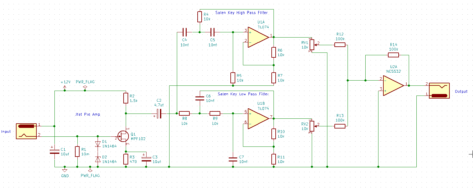

darren adcock
Sep 26, 2016
463
Sep 26, 2016
463
I drew up the pre amp, filter and filter mix circuit so to make things clearer here also, the sections are from different sources on the internet that I have working together. In case there is any issues here also.
