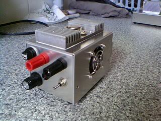

Hi all.

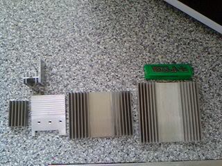

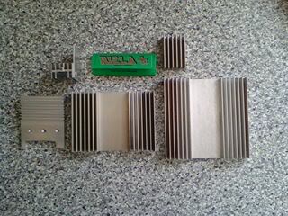

Ive put a couple of heat sinks together, and what i know they can handle.
As you probably guessed iam a fan of air cooling using axial fans, small 20mm large 120mm.
I have added the misses cigarette papers to give you an idea of scale, this next bit might sound a bit clinical, we dont need to enter the lab for every electronic procedure, my way of going is looking at production items to get an idea of power and heat dissipation and thats amps psu's etc any other components that are heat sinked.
The smallest in the picture will easily handle between 0.5 amps to 1 amp, the one down from the largest will handle 2.5 to 3 amps, and the biggest will cope easily with 5 to 6 amps, convert to watts if you want, these are guesstimates, but on experience of other supply's and heat measurements ive taken with a thermal couple connected to one of the meters i have, i normally measure the semiconductor tab and the middle of the heat sink, and for about 30 minutes at full rated load usually halogen lighting and i check simultaneously checking voltage drop and current before during and after loading the supply , none of it has to be rocket science.
The heat sinks in the pic's are based on axial fan cooling, starting at a rise to 40 or 50 degrees C. I use some supply's made and built this way daily, and have one in the electric cupboard that runs 24/7. It does not have to be difficult, with all due respect. Dave. :)
As simple as these two supply's are both can cope easily with 5 amps. One makes use of an AMD CPU heat sink, the other is an LM338K.

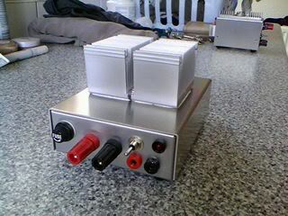

Hi jackorocko.

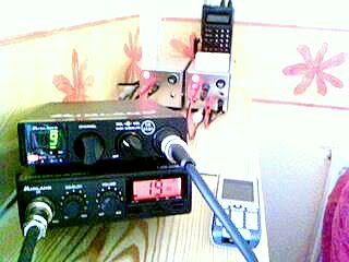

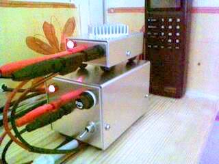

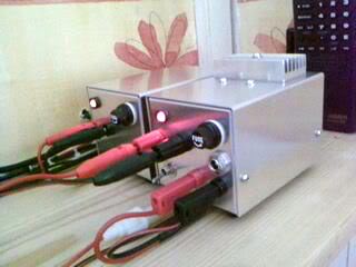

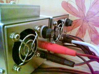

Just to give an idea on size for power, these units are simple, one contains the transformer, the other next to it is a 2 amp unit, and even the tiny one on top is capable of 2 amps, its driving 2 CB radios i use. A bench supply can be any configuration you want it to be. Dave. :)
Yes there simple supply's but it gives an idea on heat sinking.
The two machine screws in the second pic down, the one with the small heat sink on bolt up the thermal switch, and the smallest is a chip set cooler from an old pc.
