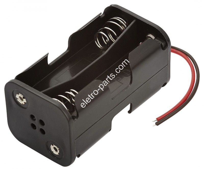

Is it any problem if I store AA Ni-HM batteries in this device in the long run?
(*steve*)
¡sǝpodᴉʇuɐ ǝɥʇ ɹɐǝɥd
Jan 21, 2010
25,510
Jan 21, 2010
25,510
As long as nothing can short out any of the exposed metal contacts, it's OK. Clip off the exposed wire ends of the leads as these represent probably the greatest threat of shorting to each other or to another terminal.
Contanto que nada possa curto nenhum dos contatos metálicos expostos, é aceitável. Remova as extremidades de fios expostas dos condutores, pois estes representam provavelmente a maior ameaça de curto-circuito entre si ou com outra conexão.
gamer87
Mar 11, 2017
261
Mar 11, 2017
261
i not good use this device and AA battery?
(*steve*)
Jan 21, 2010
25,510
Jan 21, 2010
25,510
It is acceptable as long as you take precautions.
É aceitável, desde que você tome precauções.
