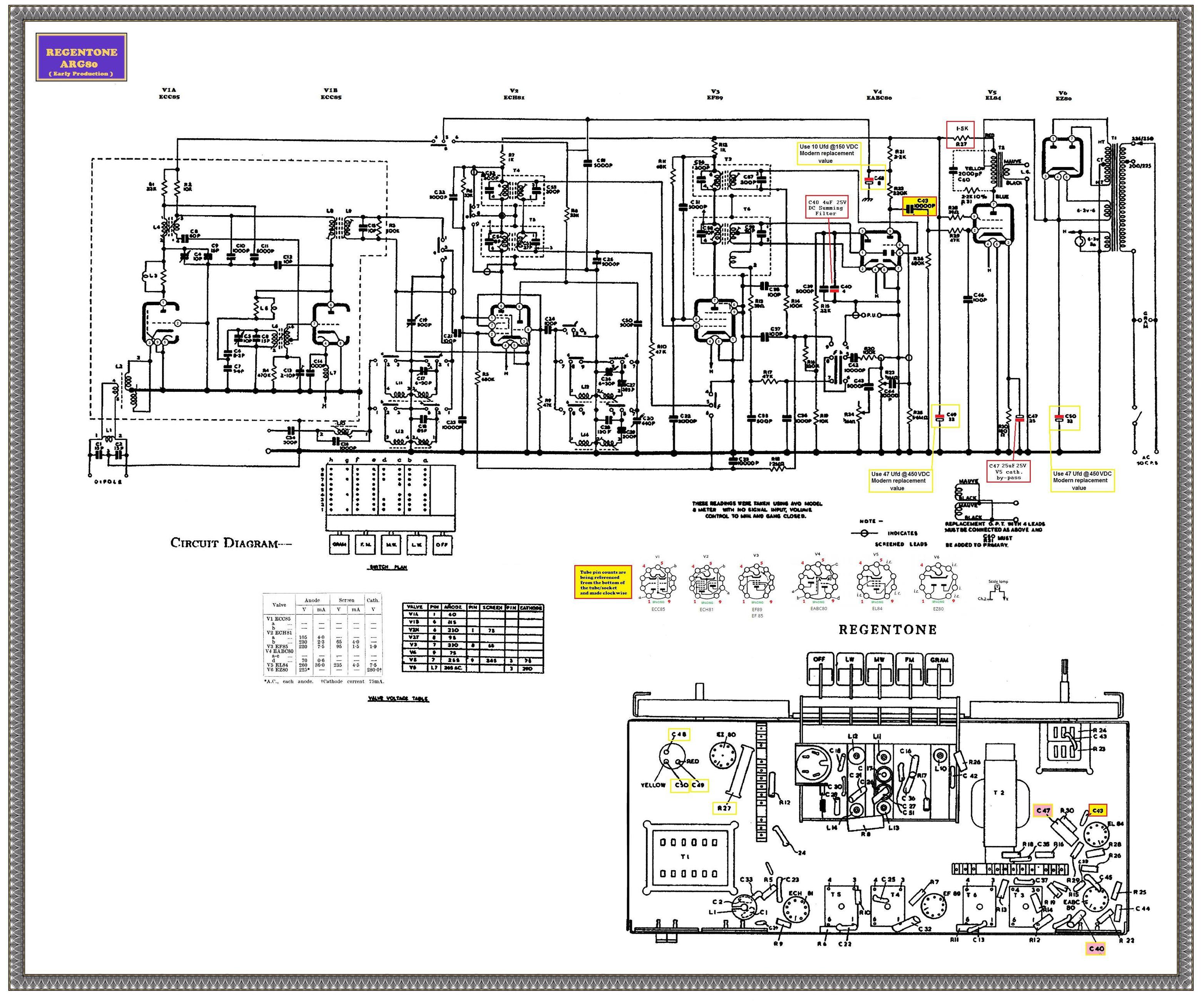

If you look at my first entry on the scene and consult that schematic, you will see the most dominant marking on the schematic is a yellow square.
Which I intended to remind you of as the LAST thing after having analyzed the sets problem.
Looks like its importance has NOW transitioned to number one.

Next Step . . . . . . .initiating . . . . . . .The Fix :
You need to clip the lead of the C43--.01 ufd cap free at its / the lead that connects to the R29 / 47K and the R24 / 680K resistor junction.
( Do duly note that on some olde ray-dee-oo skee-matics, you just have to grin and bear it on their clarity of labeling parts with your main assist of being able to read the label or color coding of a part itself.
That then only leaves the clarity of the R or C of a part designator and its number, but fortunately, they usually assign them sequentially, as they travel across the schematic page.)
Sometimes, even being able to GET a copy of an old schematic, ends up in your having to make the best read of it, as is possible.
(Archaeologists poking around and finding Dead Sea Scrolls, best make the best of them, and not keep poking around in hoping to find a tablets REVISED editions.)
Fire up the set again and after warm up, DC voltage meter the plate (P9) of the EABC80 to see what it is . . .expecting approx 75 VDC.
Then move + probe over to the now free end of the .01 cap and see how much voltage was leaking thru to upset the EL84's specified negative 7-8 VDC.
To positively confirm, take a clip lead that has one end grounded and bring its free lead up to short out your metered junction and see the voltage drop to ZERO.
Then after removing that clip lead, see what DC voltage level rises up.
A good modern replacement cap with the now typical polyethylene , polystyrene or mylar dielectrics usually only show less than a volt of static DC voltage bleed thru.
You should now know just how BAD the situation was, with that old paper capacitor.
Get a new replacement capacitor and if you want a service / reliability benchmark on into the next millennium, get a 400 or 600 VDC rated one.
Replace that capacitor.
With the bias shifted on the EL84 and having the resultant weight of an "elephant on its back", before,the EL84 was not even aware of some pip squeak little audio signal trying to come in from the EABC80.
NOW, your phono input or even the radio proper might operate, if you have that suspected one bad IF stage tube (with its open filament) having been replaced now.

Did I understand that you have replaced the .01 capacitor between the pin 9 of the EABC80 and the 47K and 680K junction that ties into the EL84.
Here is your UNITIZED new / old first production run schematic for that set :

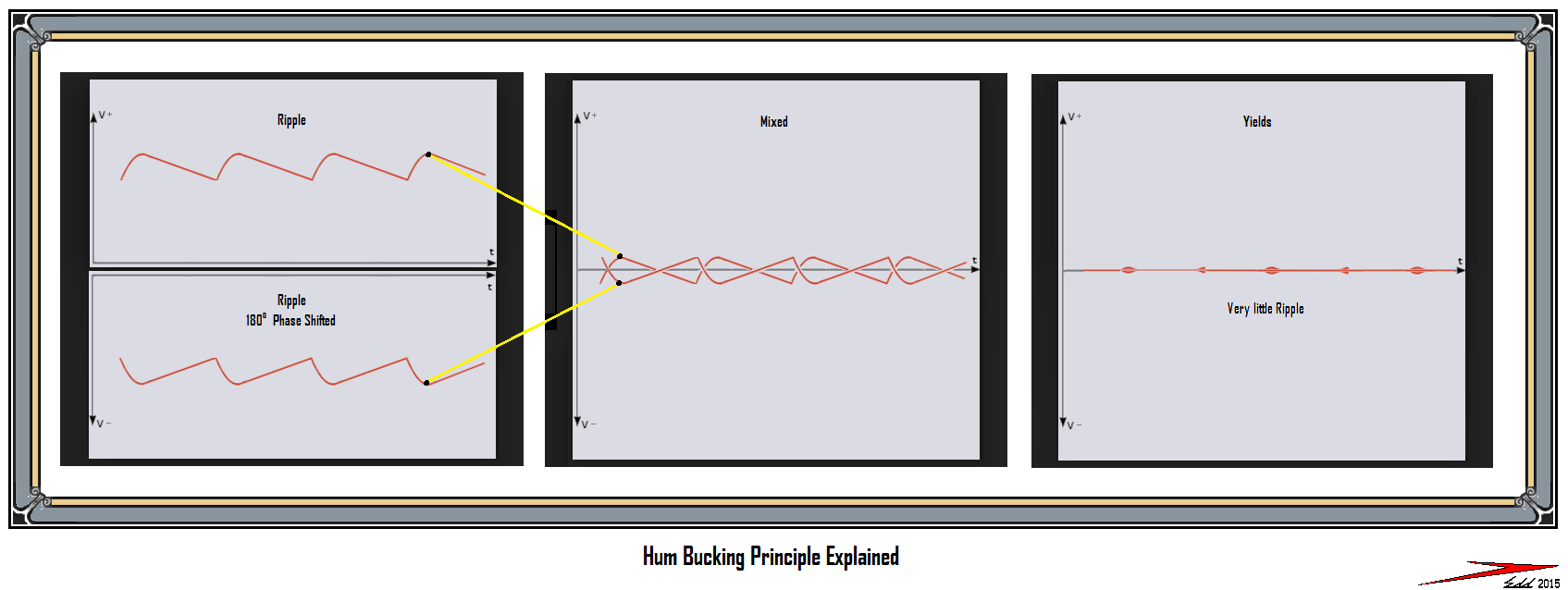

Technical Aspects Explained :
Re . . . . . . .Why that odd audio output transformer ?
Normal signal flow is for B+ to flow down the YELLOW-BLUE output transformer path and there may be some undesirable AC component called ripple present.
It shows up in the speaker as a different degree of hum, in accordance to its strength. It is permissible to hear a bit of hum if your ear is being placed right up against the speaker.
AND the AF audio output stage is MORE tolerant of SOME ripple than the OTHER earlier audio stage, since IT would amplify that ripple up before presenting it to the output stage to amplify further and then create an even greater degree of hum.
Here is where I might loose you, but if there is ripple passing thru the YELLOW-BLUE transformer winding path, it will induce a like ripple into the yellow red winding, but it will be inverted 180 degrees in phase from that of the initial YELLOW-BLUE ripple signal.
Now when normal B+ ripple at the Yellow lead passes thru that YELLOW-RED winding, the two phases now present will interact with each other to end up with an overall production of LESS ripple voltage content coming out of the end RED lead than was initially present.
This sets output transformer selection and windings are utilizing an olde design principle called hum bucking. In olden tymes capacitance in the 4-8 and 16 ufd values were being the norm, with higher capacitance being hard and expensive to accomplish.
With the utilization of hum bucking, they are letting two 180 degree phase differences in hum signals work against each other to greatly minimize the final hum output from a power supply.
Now a days, electrolytic capacitors up in the 100's of ufd at higher working voltages are readily available and cheap.
If that info was technically . . .. . . . .WHOOOOOSH . . . . right over the head, my shifting to a mathematical analogy might be somewhat helpful in clarifying the prior situation.
Say the ripple content of the main B+ at transformer YELLOW lead is assigned a mean value of +10 and the induced ripple signal into YELLOW-RED is being -9 (since its being 180 degrees phase shifted from the main B+ ripple.
After they have mixed, passing from YELLOW lead to RED lead thru the transformer , the SUM of an initial strong +10 ripple and an induced -9 ripple level is yielding a +1 ripple level, with that +1 being a LOT less ripple than we initially had with the starting +10 ripple value.
