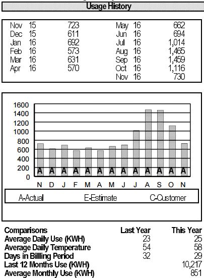

  • How much electricity do I need to generate to cover my monthly bill? Here is a picture of my monthly energy usage from my electric company.

Thanks for replying. 25KW per day is my daily usage, so if I could even generate 500w an hour, I would be able to cut my bill in 1/2.
