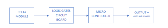

input signal will come from a accelerometer so im using 3 relays to control the output of the alarms such like a voice alarm stating the intensity of an earthquake and light signals.
from accelerometer to relay module.
from the relay module to a logic gates circuit board.
now my problem is how can control the relays using logic gates and from logic gates connected to a microcontroller for the output.
Which accelerometer?
I don't understand the need for the relays. An accelerometer typically will deliver an analog or a digital output proportional to the measured acceleration. This signal is usually not suitable to drive relays. Since you already plan to use a microcontroller, the simplest way is to use the microcontroller to measure the output from the accelerometer, then decide in software which sound to play.

the relay is for interconnection to other system but the assignment is this
to get the output intensity im going to use the relays.
example :
the relays are 12v
first relay is set to trigger on intensity 3
second relay is set to trigger on intensity 5
third relay is set to trigger on intensity 6
now using those contacts from a relay i must ensured that the alarm from the relay is not simultaneously.
here's the thing about earthquakes the force or the intensity receive by accelerometer is not going to be a flat outcome.
first the the accelerometer will receive low intensity then as earthquake goes it will receive a much higher intensity until it reach its peak movement. so if the first intensity receive by the building is intensity 3 then after a couple of seconds it receive a intensity 5 then afterwards intensity 6 all the relays will be triggered right?. now my theory is to use or make a logic gates circuit board connected to a microcontroller to control the out put. because i dont know how to connect a 12v relay to a micro controller directly. and a condition of alarm like this.
  • If relay 1 is triggered by the lowest intensity give a signal to the micro controller to release an output to a speaker and lights. then relay 2 and 3 can be triggered too for a higher intensity and release a signal to a microcontroller.
  • If relay 2 is triggered by the mid intensity give a signal to the micro controller to release an output to a speaker and lights, then relay 1 cannot give a signal to the microcontroller even if it is triggered by low intensity, then relay 3 can be trigger too for a higher intensity and release a signal to a microcontroller.
  • If relay 3 is triggered by the highest intensity give a signal to the micro controller to release an output to a speaker and lights, then relay 1 and 2 cannot give the signal to the microcontroller even if it is triggered.
for a simple explanation there will be a low priority , mid priority and high priority alarm using 3 12v relays.
My question are
1. Is there any electronic device you can offer that i can use for the prioritization of relays?
2. can i directly connect the 3 12v relay to a arduino uno r3 so then i can program an output of recorded messages?
3. or should i create a logic gates circuit board using IC then connected to a Arduino Uno R3 microcontroller?
Or do you have any suggestion?
Your help is very well appreciated man! Thank you!
You can't connect the relays directly to the accelerometer. You need to evaluate the output from the accelerometer to determine which intensity is present. This is best done by the microcontroller you have anyway.
In my opinion your approach is completely wrong. Why do you insist on using relays? Is there anything in the problem statement that you haven't mentioned? Or am I missing something?
No. The arduino has 5 V compatibel inputs and outputs. As stated above, relays on the input side are useless. To drive a relay on the output side you'd have to use a driver (module). But you don't need the relays at all when you connect the accelerometer directly to the arduino. Here is an example how to read an accelerometer by an arduino.
Follow the path mentioned above and you don't need an extra circuit board.
