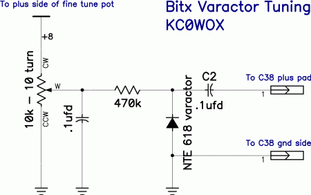

this is a good article too "Replacing polyvaricon tuning for varactor tuning"
http://golddredgervideo.com/kc0wox/bitx20amods/varactormod.htm

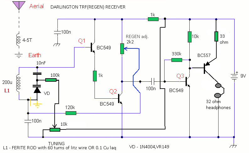

thanks mand, yesterday i make my one trf radio, so now is time to experiment, very cool tutorail
yesterday i've tried it .... and it works
first, I use polyvaricon first. then i just use diode varicap. I do not know why the radio sounds more detail when using varicap, that's my opinion

"Detail" of sounds is high frequency response. When humans are young we can hear as high as 20kHz and CD players and MP3's produce it. FM radio goes to 15kHz and sounds good. But an ordinary AM radio MUST cut the 10kHz interference beat frequency produced by adjacent stations and ordinary interference between them so its frequency response cuts frequencies above about 3kHz. A TRF radio has only a single LC tuned circuit so its frequency response is determined by the bandwidth of the tuned circuit which is affected by using a varactor to replace a mechanically variable capacitor.

Back to first circuit.
It work as is given with 500pF air variable capacitor as MW TRF receiver.
if you wish to turn it as normal regen look into modifications.
This circuit can work on smaller voltages using 2 AA batt - 3V.
