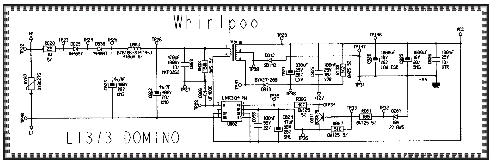

Dear friends,
I have in my hands a Whirlpool L1373 (invensys 475560 board from a washing machine. The PSU on the board is damaged, blown capacitors, LNK304PN switch chip, and a broken (broken leads) smps transformer marked 13ES-X33.
My problem is that it is impossible to find a replacement transformer so that i can make the board work.
After digging into it i found a schematic of the board's PSU and i thought that maybe i can replace the original psu with a linear symmetric psu. According to the schematic the board requires -5Volt and -12Volt. I came up with the following circuit "see attached picture". What do you think ?
Would it be possible to find such transformer somewhere or proceed with my plan <<B>>?

After taking a closer look to the schematic i noticed that it uses mains phase as common rail so i now seriusly doubt that i can replace the psu.

I doubt if the "original" schematic is in order. Did you trace it or was it available as a drawing?
It's not possible for the electronics in a washing machine to be "hot" wired.
Even if it is :eek: , you can technically connect the "common" of "your" power supply to the "phase".
I will NOT do it. :D

P.S. I do get the feeling that the schematic may be wrong. I think that as reference point (0V) the neutral side of mains is used or diodes D29 and D30 should be facing the other way right ?

I share ramussons's doubts as to the accuracy of the schematic. For safety reasons, don't rely on it.
A linear supply should be ok, providing you don't need to draw high current from any of the outputs. Alternatively, SMPS supplies of appropriate voltages are probably cheaply available off the shelf.

My concern is about the mains line being present in the output because i cn see that the capacitors on the output have their positive side connected on the same line as the varistor. the capacitors polarity could be explained if the output voltage is indeed negative
If a mains rail is indeed used as reference point for the negative supply voltages then i can not use my linear transformers center tap as reference point for the output voltages.
I could possibly disable the mains input of the board but then the machine will not work since mains is fed through selector switch and alo from on board relays feeds other components such as the heating element and the motor.
I don't think it should be there. My guess is that someone has created that schematic by reverse-engineering a circuit, but has not done so accurately. I see no reason why low secondary voltages would need to be referenced to the high voltage line. It looks potentially lethal.

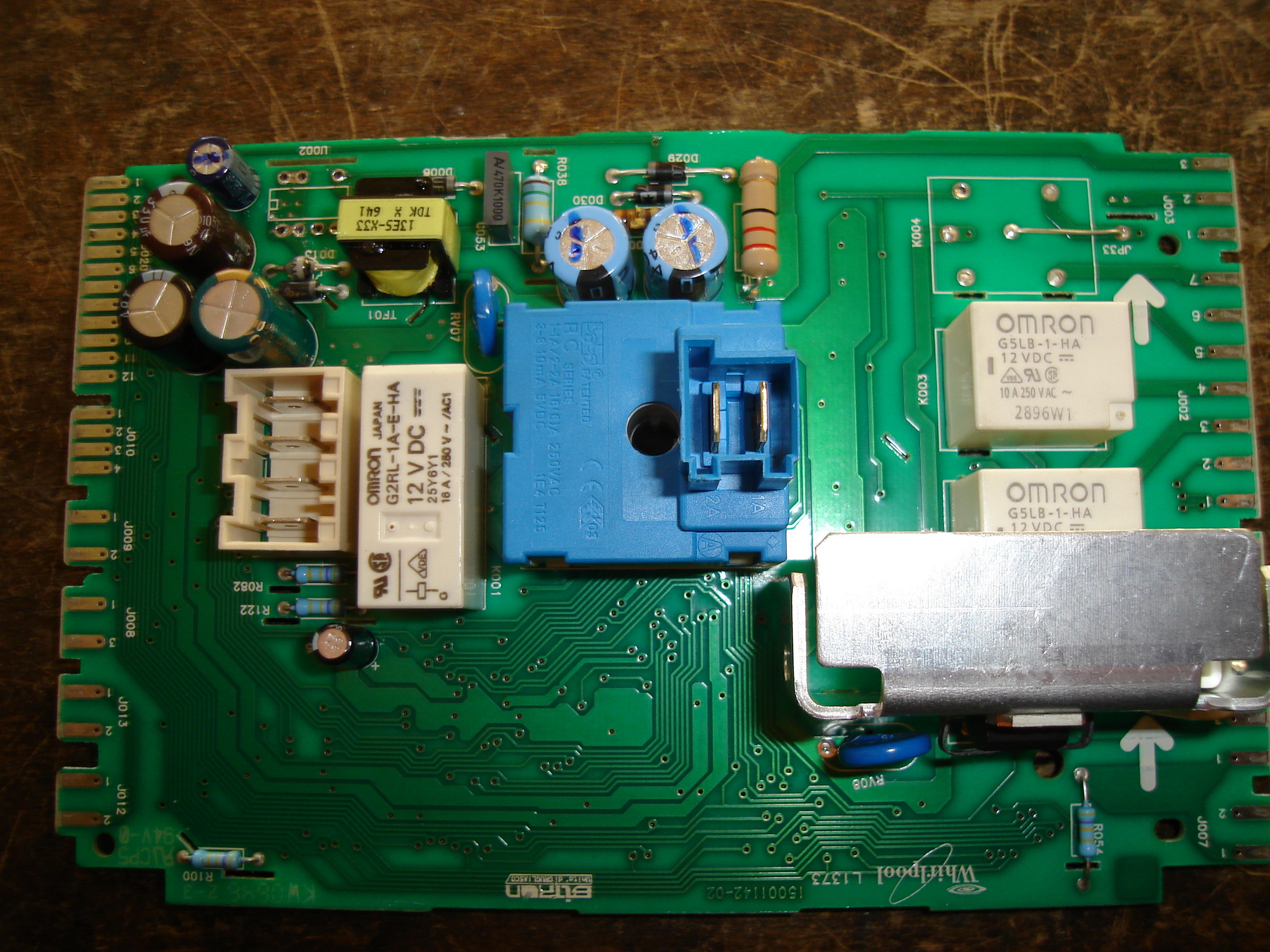

Ok after further reserch i can see that the above diagram is different (probably for a different model pcb). Here is one i found that checks with the PCB wiring.
on the upper left corner is the diagram of the PSU. I also see that the mains Line is connected with pins 1,2,7,8 of the LNK304PN switch and with the transformer's secondary winding and output capacitors positive side, so the first diagram is correct in that part.
As far as i can tell the 330uf Capacitor is the -12V output and i assume the 1000Uf capacitors are the -5V output.
Maybe now can shed some light on my darkness.

So much for my theory ;). In the latest schematic I make TP48 = -12V and TP29 = Vcc = Phase = +xV (+5V?), both voltages referenced to TP31 = GND (common). So GND is floating xV below Phase. I don't see any -5V supply?
Tp31 may be reference point indeed. though i am not sure this black symbol is (common) symbol.
why do you think vcc is +5V? what is Vx ? i assume it is -5V judging from capacitors polarity.
It's marked 'GND'.
xV is an unknown quantity. Where do you get "5" from? It most likely is 5, because it's the supply voltage to the micro.
The capacitor polarity indicates that Vcc is +ve with respect to GND.

Yes you are correct on both. It is a bit hard to read this schematic with such low resolution.
I dont understand how Vcc is 5 volts while the winding is connected to Mains line.
I understand the circuit from mains, varistor, filter caps, switc, and transformer's primary. I also understand the feedback loop for the switch but the circuit on the secondary side i do not understand.

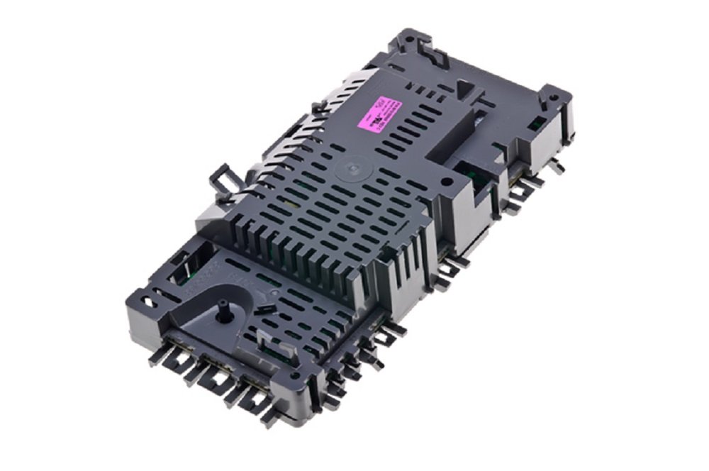

Below is shown a particular Whirlpools power board section that "blew" on the primary side, as you can see by the heated choke between the primary filter caps for the raw DC supply, along with the pulled power IC..
(Clickee-clickee on, to . . . . . .makee . . . . . . BIGGIE-BIGGIE)
I see that there is a board available from Phoenix USA . . . .wherein a repairman bought a new board and that did not fix the machine . . . and then, he did the common car "mechanic" technique of replacing
every other possibly suspected part until it was finally fixed . . . . . and then he made out the bill.
Anyhow, the used board is for sale for $20 as of the 19th of Jan 2016.
It is a Cabrio, vice Domino but the internal power supply parts are probably being the same.
http://phoenix.craigslist.org/wvl/sop/5410480668.html
