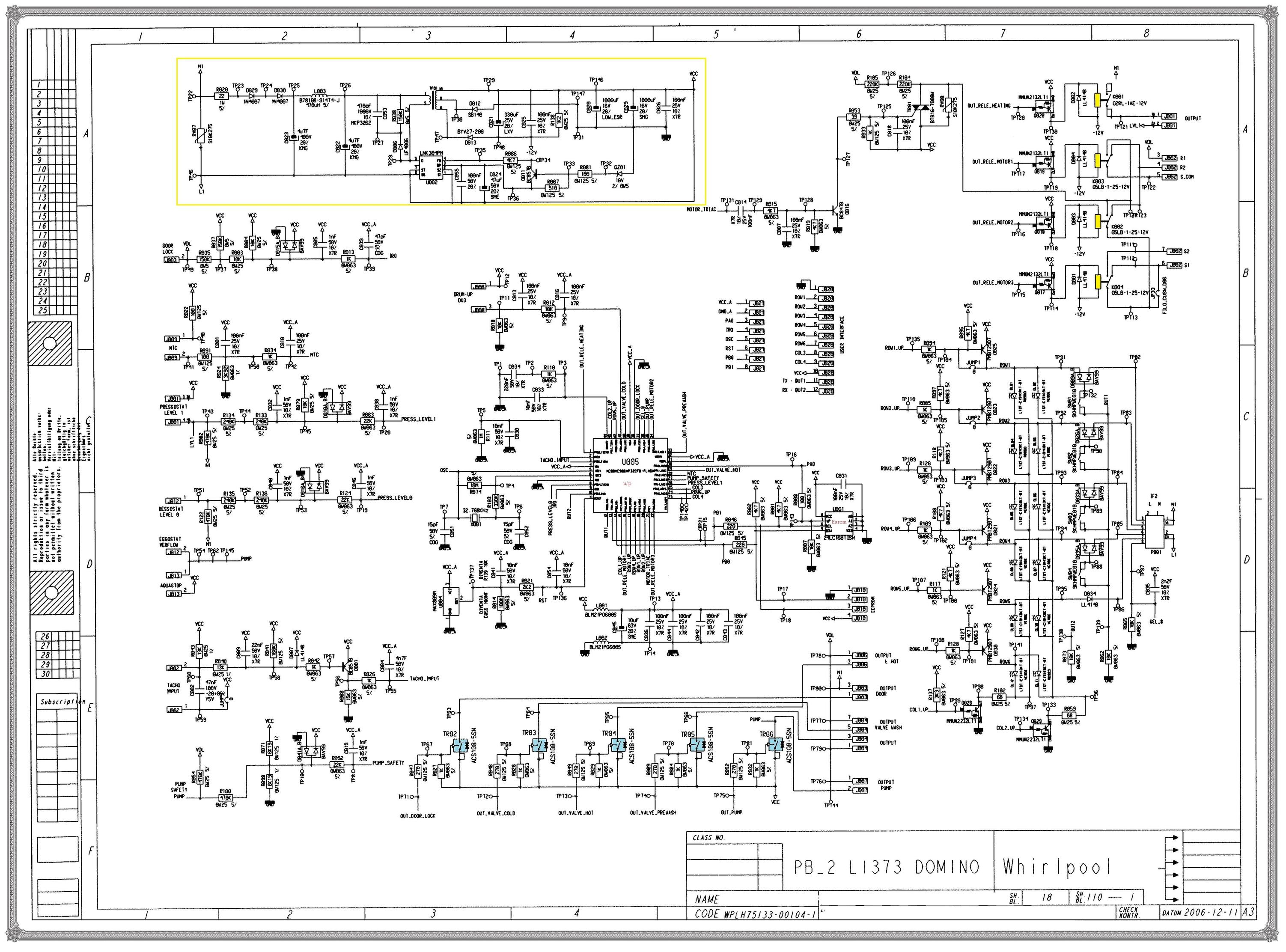

I dont understand how Vcc is 5 volts while the winding is connected to Mains line.
It's because voltage is always a potential difference. In this case Vcc is tied to the mains line, but the GND point is floating 5V (or whatever) below Vcc.

If it were me I'd probably buy a couple of generic off-the-shelf SMPS supplies (one +5V, one +12V) and wire them like this :-

I already have the transformers and the regulators so why order smps and wait a month to get them.
I have no idea how this circuit works. I have never seen a power supply using mains voltage at the output as reverence voltage.
Are you sure it is safe to wire it like that ?
Practically there is no difference as far as voltages are concerned if i use your circuit "with smps" or mine "with linear transformers and regulators" right ?

I am still a little afraid of what will happen when i i connect the +5v rail to the mains line !!!
It may just be due to the fact that i am too ignorant to understand how it works.

When it comes to mounting your components in the machine, remember that ALL parts of your added circuit should be treated as HOT/LIVE and housed in an insulated, ventilated enclosure accordingly.

So do you think that my design in post #1 picture #1 is correct and will work if i connect :
+5v to VCC(tp146), transformets middle rail to GND(tp31) and -12 to -12(tp48) ?
Well, you won't need four regulators: two will suffice. I think you could go with the +5 and the -12 wired as you're suggesting. Alternatively, if you choose to go with the +12 and +5 you should be ok if they're wired similarly to the diagram in post #23. Fingers crossed!

Ok after further reserch i can see that the above diagram is different (probably for a different model pcb). Here is one i found that checks with the PCB wiring.
on the upper left corner is the diagram of the PSU. I also see that the mains Line is connected with pins 1,2,7,8 of the LNK304PN switch and with the transformer's secondary winding and output capacitors positive side, so the first diagram is correct in that part.
As far as i can tell the 330uf Capacitor is the -12V output and i assume the 1000Uf capacitors are the -5V output.
Maybe now can shed some light on my darkness.
