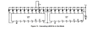

one more practical question will 16 bar graph type LED's fit on one of these, side by side

Hello,
No, The V- should go to the - of the 12 Volts.
The Rhi could be a value between Ref and +12 Volts.
Bertus

ok so please can you do an example in schematic picture, also how to cascade in bar graph mode please

could you draw on to the image above how to wire it if you can? cheers

I'm looking at the datasheet, and it says to connect Rhi to pin 7 of the LM3914 how do you make The Rhi be a value between Ref and +12 Volts.?

just to clafify at this point is the REF virtual voltage 6volts

I've read the stuff on LM3914 how would I hook this up if I connected the pin 4 Rlo to REF of the buffer circuit how would I set the Rhi to be inbetween the REF and +12v

The reference voltage can be programmed from between 1.2V and 12V. Unless the voltage divider is being externally manipulated, RLO is connected to ground and the voltage reference is fed to the RHI input. These are the two ends of the voltage divider, which divides the reference voltage into ten equal voltages, determining the threshold for each step of the display. For example, at 1.2V reference, each LED represents 120mV if input signal increases. If the reference voltage was set to 12V, each LED would represent a 1.2V increase in the input signal.
The REF OUT pin has a constant, nominal 1.25V between it and ground.

I think you missed a bit, I am going to be connecting the Rlo to the REF virtual ground of the buffer wich is 6V, and the -V will be connected to ground, Rhi should be between this REF voltage (6V) and +12V so I choose (9V), how do you wire it??

how do you make it between REF and +12V, resistors??
bertus, I feel you understand the problem a little better, can you shed any more light on this matter please? if im supplying Rlo with the reference ground from the the buffer circuit, how do I set the Rhi value to say, 9V? cheers
