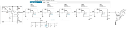

how to set Rhi.jpghow do I set Rhi please?

Hello,
No, The V- should go to the - of the 12 Volts.
The Rhi could be a value between Ref and +12 Volts.
Bertus
I'm just going to leave it at 12v or put a variable resistor 10k

I think this

Is it correct?? I think it looks good to go! if not can you modify the diagram to express how it should look please?

I've got the part in green but have to get it connected to the LM3914! (green part)diagram.png

I get why the REF virtual ground is put to the Rlo, it's because 6v is the lowest instead of 0v and the upper limit is between 6v and 12v I just don't know how to set it up

Hello,
The Rhi is dependend on the signal you get out of the detector.
Set Rhi in such a way that the maximum of the detector shows all leds.
Bertus

I got this far in the chain just need little nudge in the right direction

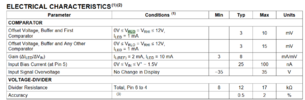

So I have read and re-read the datasheet and I'm still confused, I can see that VRlo needs to be greater than zero and VRhi needs to be less than 12V so I know how to set the Rlo that bits easy, just put the REF virtual ground. But how do you set the Rhi to 12v because Rhi and refout are connected ? cheers

I recon I'm overthinking it can you screen shot and red box the part that tells me where and how to set Rhi to 10Volt please?
