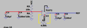

hello,
what is the voltage in the middle of the two resistors?
bertus
bertus
Nov 8, 2019
3,877
Nov 8, 2019
3,877
hello,
the voltage should be on the + input of the opamp:

I have not read this entire thread but hanging 10 uF and 100 uF on
the output to ground I would think ill advised due to stability issues.....

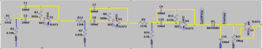

got new proto board going to make a start on the circuit from the beggining with colour coded wires and thats the (mic to pre-amp, amp, and REF GND circuit and then the filters and buffer) hopefully get the right results this time

is this be right? included original so that you can edit if wrong!

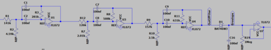

Hello,
Yes, if you follow those colors, you will have more overview over the signals.
