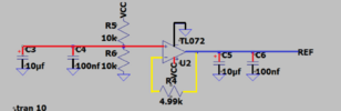

let me know though because I'm going on for approximately 45mins in a second! I wa going to use the electrolytic for the 10uf and film for the 100nF1711659675088.png

no the the 100nf caps I'm using are film type but I was just saying that I have electrolytic ones in the box I bought I do remember you saying that the 10uF ones on the REF GND circuit would be fine though!
do you remember saying that I could use electrolytic caps for the 10uF REF GND circuits?

hello,
the value of r4 is not critical.
you can use either value there.
there are even circuits around where there is a short in stead of the resistor

4k7 it is working on it till 12 it's 10:40 here now so if you guys have anything to say while actually working on it that would be great!!

hello,
yes, that is fine.
the gain will be 5.1 in stead of 5.0.

cool so tested the REF GND part of the circuit and its as sweet as a nut measureing exactly half the input voltage eyes were getting really tired at the end of that session almost like soldering in the dark still took pics for you!! the strangly yellow wire is the out put to the filter which I will start on the filter and buffer as soon as my eyes are working properly again, perhaps tonight, thanks and the soldering is not too shabby either

actually I'm not certain if I did or did not! I will do it next time round! thanks is there any way of seeing if the pre-amp and amp is working before proceeding to making the filter part for the first column LED cicuit?

hello,
you could connect the preamp directly to the peak detector circuit.
that way you will see all signals going into the microphone on the display.

HAPPY EASTER!!! in this schematic there are effectivly two 10uF caps going from the negative to positive is this okay or should I just use one??!!!??1711905189337.png

Hello,
Decoupling capacitors are place close to the power lines of EACH chip.
Read this thread on AAC for more info:
Bertus

The 2.2 microfarad solid tantalum or 10 microfarad electrolytic are nominal values,you may need more; to avoid oscillation on each LM 3914 you use for your application in addition to recommended lead length to LEDs... I know you're going to bookmark this, that's okay.

Hello,
Bertus
my internet won't let me access the site! it's ok went through the search option on the site instead of the link I'm on it!
