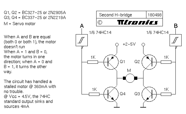

Great, i found something so simple it can't go wrong.. Just 4 transistors and i can easily understand the logic..... Here's it is:
Now, this looks fine since my parallel port can supply to the base of a transistor easily. But i have one question. See those 1K ohm resistors connected to the base ? What purpose do they serve ? Can i do without them if my current output is low ?
Thanks.
(it will work right ?)

Without the resistors you would effectively be shorting your power supply through the base-emitter junctions of the transistors -- that would be a bad thing. (and that's just the start of it)
If your current is very low you could increase the value of those resistors.
Since you're driving a motor, protection diodes for the transistors may be a very good idea (place a reversed biased shottky diode across the CE leads of each transistor).

Ah, here's the problem. If this device is attached to your parallel port an the pins A and B are set to the wrong values, you could turn on Q1, Q2, Q3, and Q4 at once.
The results of that are likely to be less than marvellous for the transistors involved.
The other problem is that to turn on Q1 or Q2 you need to raise the base to a fairly high voltage. If your parallel port only uses 0 or 5V logic levels then these transistors will not saturate, the voltage drop across them will be quite high, the motor will get a lower voltage, and the transistors may get hot.
I would advise you to go with the circuit you suggested earlier. It is intrinsically safe as there is no combination of inputs that will fry your transistors. You can ignore the inverters if you like, and the parallel port *may* be able to deliver enough current to operate the H bridge.
The other thing I would add are protection diodes across the transistors.
Also, if you are connecting stuff to your parallel port, the last thing you want is to fry it. It may be very hard to replace if you do so. So be careful.

Last thing first :) I originally pointed you to a comment made by yourself, thinking that it was made by someone else. I corrected that with the observation that "you are eptheta!"
The way to avoid the large voltage drop is to drive the transistors transistors correctly. That means you need to be able to get the base more positive than the emitter (for NPN transistors). Depending on the saturation voltage (VCEsat), the base current, and the base resistor, this could quite easily require you to drive beyond the +ve supply rail (if you can't do this then the transistor may not be able to be saturated and the voltage drop across it will be higher). Note that I have seen H bridges designed the way your later circuit is designed, but I really don't like them as they also allow all transistors to be turned on at once.
In either case, you need to be able to bring the control voltage from rail to rail (at least). If you're using a higher voltage than your parallel port can put out (which you say is 3V) then you need some sort of buffer or level shifter to make it work properly. In the original circuit a schmitt trigger is shown which will give both a rail to rail swing, and transition from one state to the other very quickly.
Mosfets *may* be better, but they require gate voltages in the order of 5 to 15 volts -- at a minimum you're still going to need a swing of 5 volts. Transistors (especially darlingtons) have a relatively high VCEsat -- the voltage from collector to emitter when fully turned on. This may be between 1 and 2 volts. If you have 2 in series (which you do) then you could quite easily drop 2 to 4 (of perhaps 5) volts available for your motor. Mosfets often have a very low resistance (some measured in single digit milliohms) and will waste far less power at low current. For your circuit, it may be easier to run it off a higher voltage to allow for the voltage drop across the transistors.

Are you still using the circuit you posted where you are driving two NPNs each from two parallel port bits? If so, you have really not gotten past stage 1. You will have to come back and revisit it because the transistors will blow up. Might as well fix it now rather than come back to it later.
As Steve pointed out, if there is a code bug or computer crash you will have all the transistors on and they will not like it. Depending upon your power supply, you could do quite a bit of dammage.
You also do not have flyback diodes. Those are protection diodes across the collector and emitter of each of the transistors, installed "pointing up" in the schematic. Without them your transistors are seeing potentially serious flyback voltages and they will eventually fail from that.
Lastly, you are dropping a lot of power on the top transistors and they will over-heat and fail if you are running any amount of current. That said, you may not have much current because you are running your motors at about 2V. If the motors are barely crawling, you will not have much flyback either.

Acctually, I'm using 2 PNPs and two NPNs (according to the first diagram i put up) and i do have 2 diodes from the emitter to the collector of both transistors to prevent any back-flow. It works fine and the motor runs decently. I think it is fine the way it is.

I am assuming that you also have the 74HC14 in there as well and are running close to 5V.
You really do need 4 diodes, one on each of the transistors. For the two PNP transistors (the top ones) the cathode if the diode (the pointy end) needs to be connected to the + voltage. For the two NPN transistors, the anode needs to be connected to ground.
The diodes are not there to prevent "back flow" They are there to steer the energy in the motor to the power supply. When you stop driving the motor, the motor is still spinning due to inertia. It now becomes a generator and starts producing power. The diodes steer that power into the power supply. It is also called regenerative braking.
