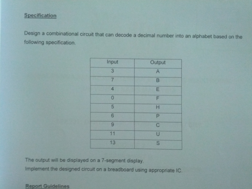

Hey there
For this circuit design, how can I implement it ? What IC can I used in the implementation of the system ?
Thank you :)

step 1:
find a suitable binary representation of the decimal number. For example youi could use straigt binary numbers, or you could choose BCD (binary coded decimal) or 1-ou-of-n code. You need to know how the decimal number is represented in order to devise a decoder.
step 2:
write down how the letters of the alphabet are displayed on the 7-segment display. Obviously you have 7 lines, one for each segment. Which lines are active for each letter?
step 3:
devise the logic for the decoder from the decimal number to the 7-segment wires using standard logic design methodologies, e.g. karnaugh maps. You can use standard logic gates like NAND, NOR; Inverter etc. for this.
step 4:
implement. Watch out for the type of 7-segment display you are using: common anode or common cathode. And don't forget the current limiting resistors for each LED in the 7-segment display.
Alternatively you could use the decimal number as the address to an 8-bit wide EPROM and program the EPROM to give the corresponding code for driving the display. That, however, is most probably not was your instructor meant when he assigned this task.

That will not work. A 7-segment decoder IC has built-in logic for displaying numbers, not letters of the alphabet.
You will have to devise your own logic.

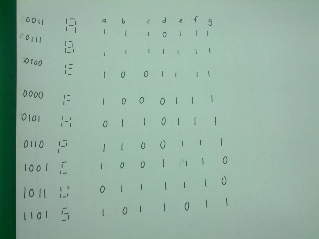

Hey, so this is what I constructed based on the given table. Is this correct ? What's next ? Karnaugh Map ?
Harald Kapp
Nov 17, 2011
14,317
Nov 17, 2011
14,317
Looks o.k. at a quick glance.
Next step is the synthesis of the logic. Karnaugh maps re one good tool.

This description is awkward for me to describe so hopefully you can follow...
One thing I will note, it might be easier to map to the 0 logic state change vs the 1 logic as the zero logic only contains a max of 3 state changes at any given time...
Basically want I'm saying is assume the 7 segment is always 1111111 and change the 0s (max three changes) to derive at the final value, instead of starting at 0000000 that can require up to 7 changes of state to display the final value...

In addition to that, it may be easier to perform the analysis for each segment.
Start with the f segment. The logic for that is trivial.
Searching for dependencies between segments first will reduce the amount of work you need to do. Are any always on or off when another one is on or off? Is the logic required to handle this dependency easier than determining its state from the 4 input bits?
Personally, I'd rearrange your list so that it was in order of the binary input. That may also highlight some patterns.
edit: I would also investigate grouping the segments in various orders to see if there are any patterns revealed.

After segment f, next look closely at segment e. It is also very easy.

Yes, I know. I mean the table I constructed for each segment is correct ? using 1 to indicate the segment is light up ? By the way , how you get e=not(A*B) = A NAND B for the segment 'e' ? Wondering.
