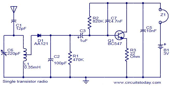

I presume you are thinking 9V means you will use a PP9 which have a reputation for not lasting. However a modern alkaline PP9 can last quite well, particularly if your radio uses headphones instead of a power amp and speaker. Alternatively you can buy rechargeable PP9 style batteries but they can be pricey particularity if you need to buy a charger as well. Thirdly you could use 6 x AA or AAA in a battery holder if you are not bothered by the bulk. Then you could use any of the 9V designs.
However, I came across this simple looking receiver which looks nice. It all depends on the performance you want.
http://www.circuitstoday.com/single-transistor-radio
This design is for the medium wave. No details are given on how to construct the tuning coil apart from it being 0.35 mH and being centre tapped. A bit of research on line will tell you how to wind one for the short wave frequencies.

Thanks TCSC
This design is really primitive but should work with not god
selectivity .

That is basically a crystal set with a 1 transistor amp.
Bob

The simple circuit is missing sensitivity, selectivity and automatic gain control that every simple super heterodyne AM radio circuit has.
