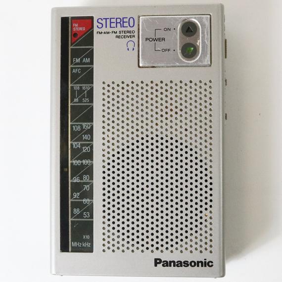

I have owned this little Panasonic "pocket sized" AM-FM-FM Stereo superheterodyne receiver, as shown in the image below, for many years. It uses two AAA 1.5 V alkaline cells. Volume from the built-in loudspeaker is not very loud, but I would normally use it with a stereo headset. These radios are still available for sale, used, on eBay but caveat emptor before laying out big bux. It is a Panasonic model RF-455. I did not find any other radios this small that operated from 3 V, much less have shortwave bands, but there are plenty larger receivers available that feature "full coverage," whatever that hype means... as I am sure you are aware.
It could be that everyone shifted to 9V batteries because it was easier to design silicon transistor radios with that voltage available. I haven't looked inside my radio for twenty years or more, but will do so soon because the volume control potentiometer needs to be cleaned and lubricated. I would almost be willing to bet that Panasonic used germanium transistors in this radio. I know the parts are really crammed together inside, axial lead components inserted with one lead directly into the circuit board and the other bent over into a "U" shape and inserted into the circuit board. It really blew my mind (as a kid) when I first saw this construction technique. I had somehow thought there was some sort of rule that components had to lay flat on circuit boards!
Unfortunately I have not been able to locate a schematic for this fine receiver yet. I am sure it could be easily adapted to receive short-wave bands from 1800 kHz up to 30 MHz because it already receives AM broadcast (530 kHz to 1600 kHz) and FM broadcast (88 MHz to 108 MHz). Someone just needs to change the local oscillator frequency and maybe soup up the front end a little.:D
Ugh! Not so fast. The transistors this radio uses are probably long obsolete and out of production. I wonder if a superhet radio could be designed from a CMOS version of the 555? That little puppy will never go out of production or become obsolete! And being CMOS, it would probably run fine off of three volts and draw almost no current. Or maybe someone smarter than me could design a CMOS radio on a chip (if that hasn't already been done) that I could buy for fifty cent on eBay... It would tune from DC to Light, or some reasonable subset of that.
